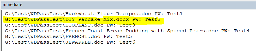

      Starting Files:
      43902-WSPassStartFiles
      Processing Messages:
      43903-WSPassImmediate
      Ending Files: (see dates/times)
      43904-WSPassEndFiles
      This should at least give you a start. Post back if you need more assistance.

      Sample file:
      Code:
      G:TestWDPassTestBuckwheat Flour Recipes.doc PW: Test1
      G:TestWDPassTestDIY Pancake Mix.docx PW: Test2
      G:TestWDPassTestEGGPLANT.doc PW: Test3
      G:TestWDPassTestFrench Toast Bread Pudding with Spiced Pears.doc PW: Test4
      G:TestWDPassTestFRENCHT.doc PW: Test5
      Note: the above was with the Append option (see code comment) after running against the list of files then deleting the PW protected files and running again against the original files.

           End With 'oDocToPw
           zNextFile = Dir()
         Loop Until zNextFile = ""
         GoTo Get_Out
      LogFileNoAccess:
        If Err = 75 Then
          MsgBox "The file: " & zPWDLogFile & " could NOT be opened!" & vbCrLf & _
                 vbCrLf & "Please correct the error and try again.", _
                  vbOKOnly + vbCritical, "Error: File Access Error"
        Else
          MsgBox "Error No: " & Err.Number & vbCrLf & _
                 "Error Msg: " & Err.Description, _
                 vbOKOnly, "Untrapped Error Encountered:"
        End If
        GoTo Get_Out:
      NoPWDFile:
        If Err = 53 Then
          MsgBox "The file: " & zPWDPassFile & " was not found!", _
                  vbOKOnly + vbCritical, "Error: File Not Found"
        Else
        End If
      Get_Out:
        Close #1  'Close PWD File
        Close #2  'Close Log File
      End Sub   'PWPDirectory
      If there are not enough you'll get a message like this:
      43928-notenoughpws
      Note: I fixed the missing space in the message in the code above.
      Pressing Ok will end the program w/o taking any action so you can fix the PW file.
