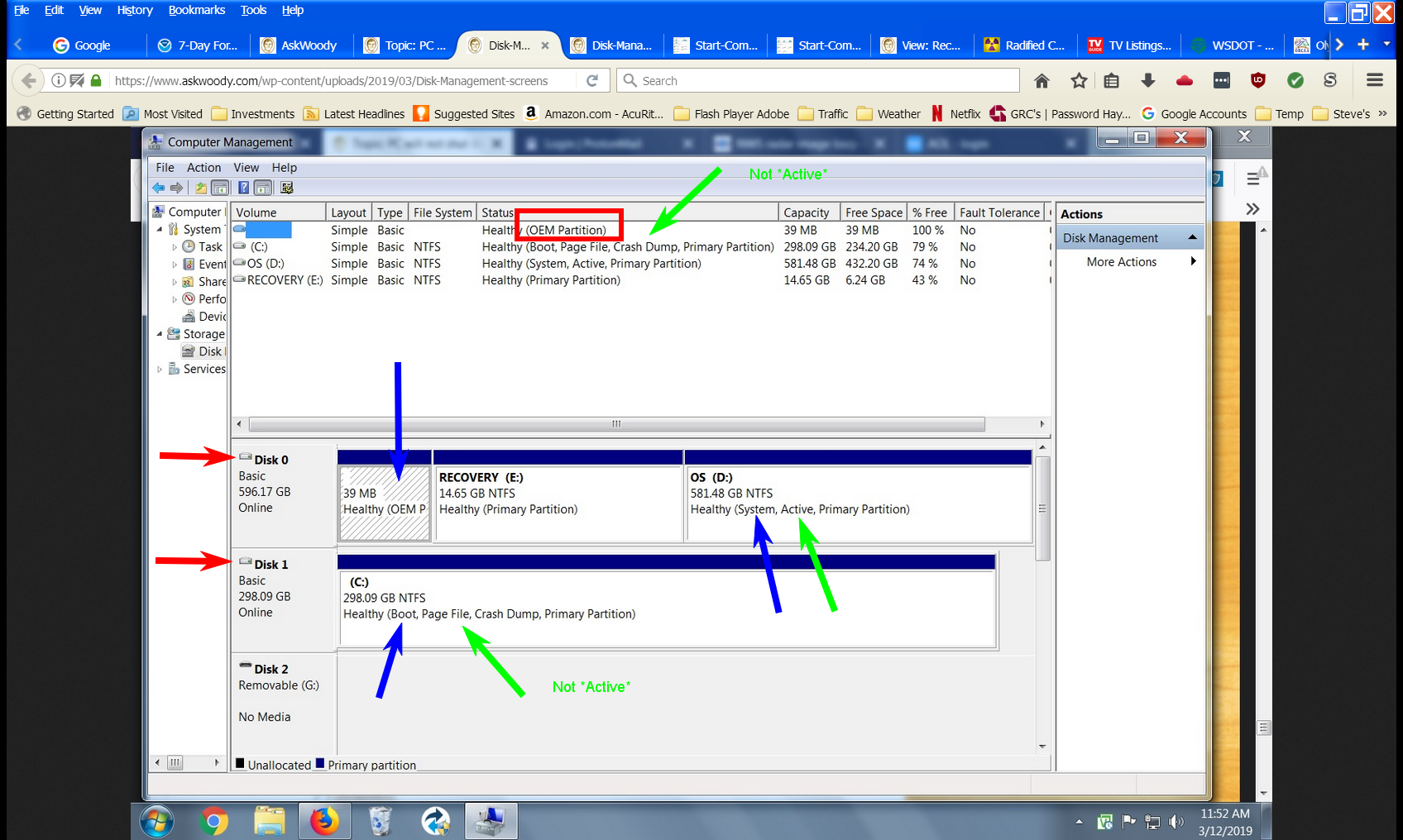

      As of now, with the Vista and W7 HD’s installed, the PC boots as always with the choice of OS at bootup.  If I do a system restore to before the Mint HD went in, maybe that would fix the shutdown issue for W7.
      That would still leave me with the no-start problem with W7 and Mint installed, but the no-shutdown takes precedence- one fix at a time.

      As far as putting the bootloader on the Win 7 drive: The discovery of the Windows disc doesn’t change anything as far as my suggestions.  Since you have it handy, it would certainly be worth a try to boot it and see if it will be able to repair it, but my guess is that it will tell you that it was not able to repair Windows (based on my recent experience with the Windows 10 install USB trying to place a bootloader on my Acer Swift’s drive).  This is essentially the same thing as following the above advice about creating a recovery disc… if the Windows disc cannot repair Windows, there’s no point to creating the recovery disc, as it will just try the same things.
      I’d install Macrium Reflect Free edition and have it create a USB or disc bootable, then boot that and select “Fix Windows boot issues.”  It should find both Windows installations, so select 7, of course, and then select the Windows 7 drive for the place to install the bootloader.  It should show that it failed on the step to remove the old bootloader, which is expected, since it’s not there.  The rest of the steps should show as succeeded, and after that it will ask to reboot, so select yes, then go to Mint and enter the sudo update-grub command again.  After the next reboot, it should show two Windows boot manager entries.  At that point you can try removing the Vista drive again, and 7 should still boot fine after that.
      As far as the shutdown issue… Other people have suggested looking in the event viewer, and that’ what I would suggest too.  It may take a good amount of drilling down through the messages and seeing what the actual text is for each one.  One thing I do sometimes is wait for an even number on the system clock and shut it down right then, so you know which log events took place immediately following the shutdown.

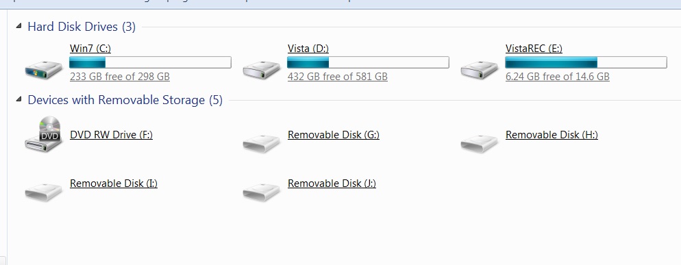

      While Linux was running, and the W7 HD was in place, the Linux OS “saw” the 7 and allowed access to the 7 Pictures file.  The Linux user manual says that, when Linux is installed in a dual boot situation, the Linux will offer the choice of which OS to open on startup, but this did not happen.  I assume that was because the bootup capability of W7 had previously been co-opted by the Vista OS when they were running as dual boot.
      I think at this point I should sit back and see what does or doesn’t happen through several cycles of booting up and shutting down W7.
      We use the “sleep” option all the time.  Should we stop doing that?
      • #338040
        Linux didn’t see the 7, per se.  It saw that there was a drive with data on it that it was able to read (since it knows how to read NTFS), so it made it available to you, the user, to browse.  That would have happened whether or not there was Windows on the drive or if it was nothing but the Windows Pictures directory.
        It didn’t give you the choice of Windows with the Vista drive removed because as far as it was concerned, there wasn’t any Windows on the PC– which is the same conclusion the system BIOS/UEFI came to, since it was unbootable there too.  They’re looking for the bootloader, and if it’s not there, it’s not possible to boot Windows, so there would be no use in putting Windows in a menu when it can’t be used.  That doesn’t mean your Windows installation is not actually there, of course.  You can go into Linux and browse the folders and see that it is right there on the disk, or install the Vista drive and see that 7 boots just fine, so clearly, it’s there.  It’s just not usable as an OS without a means to boot it.
        Once the bootloader is put on the 7 drive and GRUB is told to look again for other operating systems, it will then offer the choice as the manual says.  You’re really close to being at that point, so don’t get discouraged now!

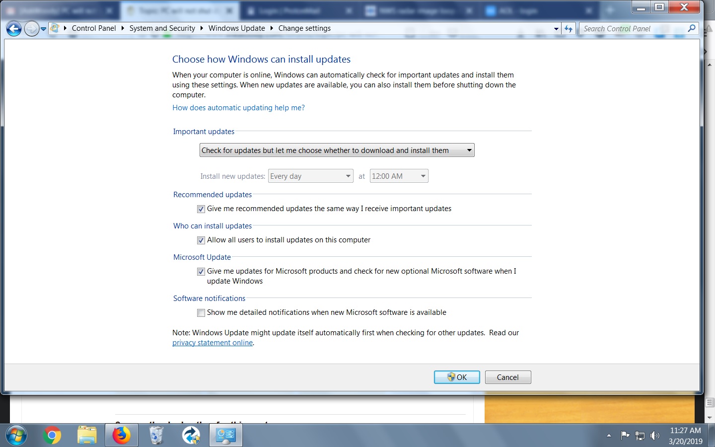

      Update:  Last 2 shutdowns were as normal.
      Searching “Task Host Window- Windows 7” brings up a number of hits relating shutdown problems to this app.  Apparently Microsoft has identified a problem and has a Hotfix available.  This repair is offered for downloading by at least one third-party site.  I’m more inclined to look for this directly from MS, but not sure what route to follow.  Comments?
      Edit- found this- https://support.microsoft.com/en-us/help/975777/there-is-a-delay-when-you-shut-down-restart-or-log-off-a-computer-that
      Looks like MS recommends the Hotfix if the Task Host Window pop-up or screen appears.  In my case, that doesn’t happen, but THW is cited as preventing shutdown.  MS mentions an update to be issued for this.  Should I wait for that or apply the Hotfix?

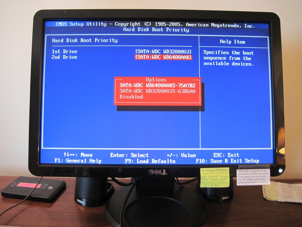

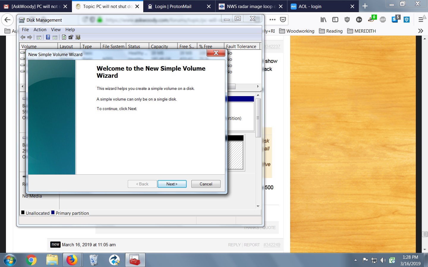

      Today, removed the original Vista HD and installed a new blank drive which is now successfully loaded with Linux Mint.
      During the installation, I unplugged the W7 HD inside the case, to be sure the new install went on the new HD. Both drives now connected, Mint working ok but BIOS can no longer open the W7 drive.

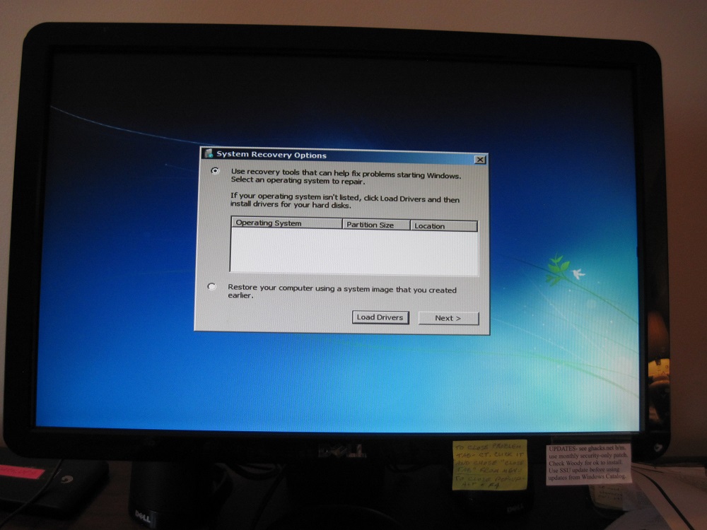

      @ Slowpoke47
      So if that is booting from a flash drive, the answer is, yes, I did that.
      But, my question had a two part sentence–part one was booting from a bootable flash drive (or a bootable CD/DVD), and part two was *did you by-pass the Windows boot sequence*.
      Having all drives where Windows is installed that are removed and/or disconnected does not count as *by-passing* the Windows boot sequence.
      In order for Rescue Media to be available to work with Windows installations for repair, image creation, or image restores, the Windows HDDs have to be installed, connected, and running.
      So, the correct answer is *No, apparently you have not used Rescue Media to boot your system, while by-passing the Windows boot sequence*.

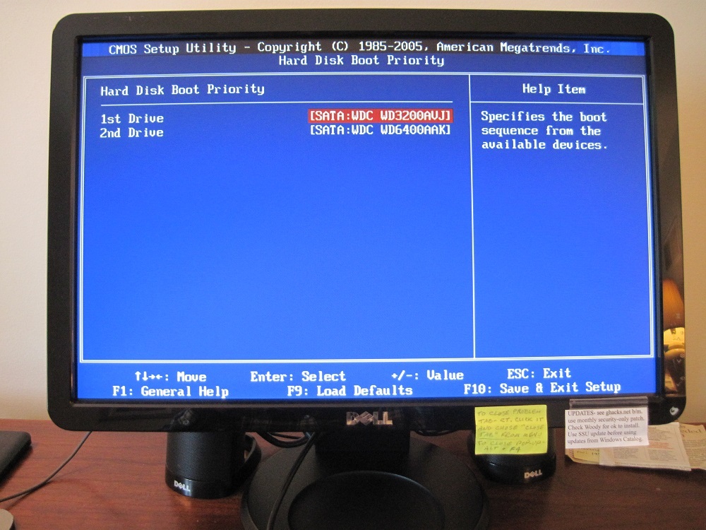

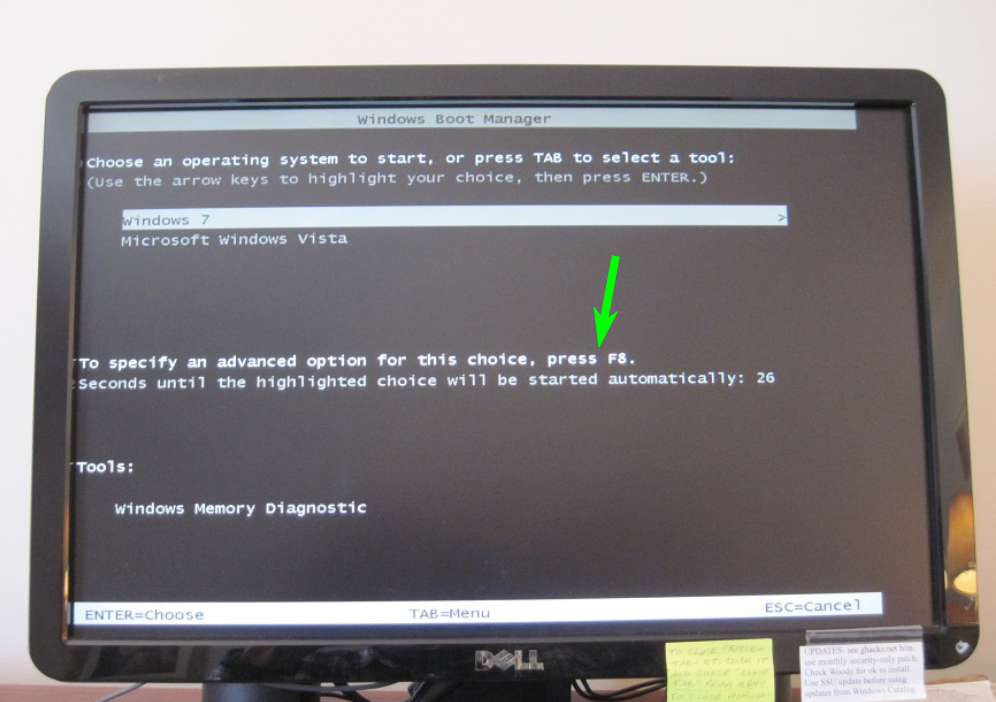

      Current status- Vista and Windows 7 hard disks still installed.  PC boots to W7 as expected.  Shutdown occasionally normal, other times slow to very slow to manual shutdown needed via power button.  Hangs up at “shutting down” and cites Task Host Manager.
      Normal-screen-on-bootup
      Normal bootup screen
      F12-Boot-Order
      F12 Boot Order
      From-F12-enter-setup
      From F12 <enter setup>
      Boot-Device-Configuration-1
      Boot Device Configuration
      SATA 3200… is Windows 7, SATA 6400… is Vista, shown as highlighted.  Tried changing the highlight to W7, either way, W7 is the default as shown in first photo.  Unknown if my selecting W7 “sticks” since I didn’t know if too many bootup-shutdown cycles would be harmful- so I didn’t reboot to check.
    • #340145

    • #340147
      @ Slowpoke47
      Great screenshots, a picture is worth 10,000 words!
      From your 4th screenshot, *Boot Device Configuration*, select the second item down from the top, *Hard Disk Boot Priority*, press *Enter*. Take a photo of that screen and post it.
      Other comments in a moment.
    • #340169
      @ Slowpoke47
      Yes, the SATA 6400 is at the top and highlighted in your 2nd photo, *Please Select Boot Device*–that is not an actual *Boot Order*, just a list of boot device options that are listed–I don’t know how the order shown is created. What’s highlighted in that 2nd photo is unrelated to the *Windows Boot Manager*, the 1st photo.
      No, it won’t *stick*. Bringing up the *Please Select Boot Device* boot menu just gives you a one time option to choose a boot device. Next time you bring it up, it will look exactly the same as it does now in that photo, unless possibly if you make system changes–then new information may show up–for instance if you take out your Vista HDD, and put the new HDD in that has the Linux Mint installed on it.
      I don’t think you have to worry too much about bootup–shut down cycles. But, you can just use *Restart*, and that will not cause a *shut down* cycle.
      Hmmm, I’ve not asked before, but just out of curiosity for now, does a *Restart* cause the same delay that the *Shut Down* command does?
      Didn’t this  time, but sometimes, yes.
      Hard-Disk-Boot-Priority
      The photo you requested.  (Whew) many steps from there to here!
    • #340212
      Looks like it’s a BIOS-based system, not UEFI.  I wasn’t sure from the start, so I gave both sets of directions, but that’s not UEFI there.  Too many chefs spoil the broth for sure, so all I will offer is that the thing about the Macrium Reflect USB still stands, and so does the thing about entering ‘sudo update-grub’ once you get the bootloader written.
    • #340223

      Just reviewing Ascaris’ post   https://www.askwoody.com/forums/topic/pc-will-not-shut-down/#post-337646 way back near the beginning of this thread, and joep517 https://www.askwoody.com/forums/topic/pc-will-not-shut-down/#post-337611 before that.  In both cases, the same question- if by either the EasyBCD or Macrium I attempt to rebuild the boot function, and since it was originally co-opted by Vista- with Vista still in the case, won’t that happen again?  Remember, I can’t boot 7 without Vista connected.
      • #340240
        But you CAN boot the rescue media without Vista connected.
      • #340254

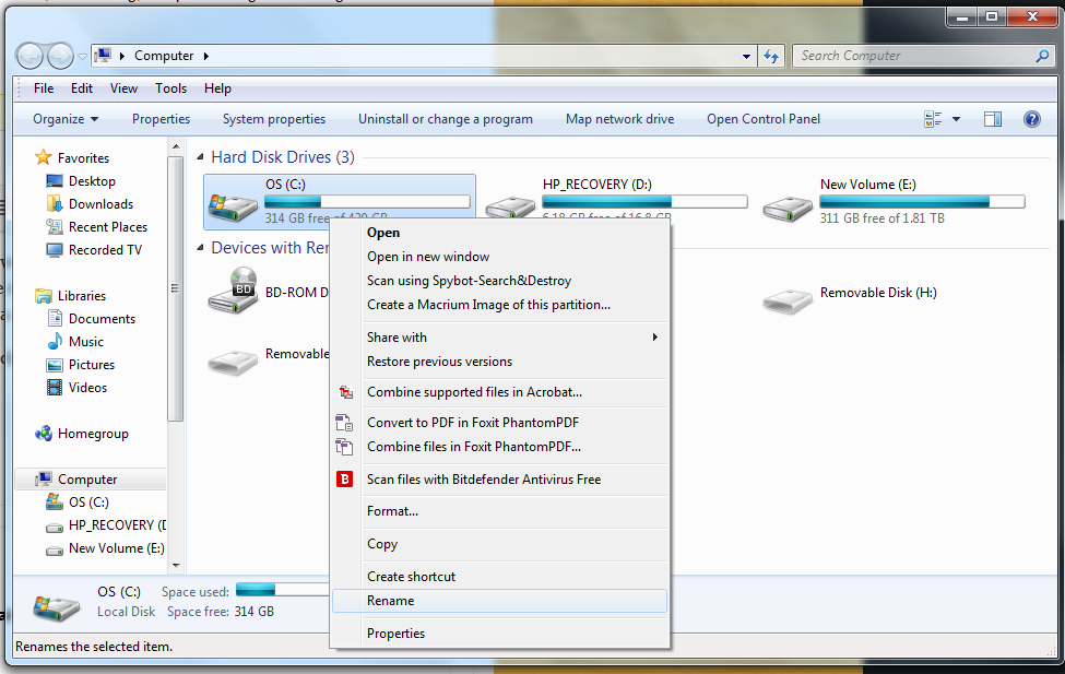

      @ Slowpoke47
      Okay, we are about ready to proceed to testing booting to Recovery Media.
      But, before that, I would like to recommend a slight bit of *house keeping*.
      I would like you to consider naming, or if already named, re-naming your various partitions so they have *descriptive* names that are *memorable*. So for instance, here’s a screen shoot you posted previously in this thread:
      https://www.askwoody.com/wp-content/uploads/2019/03/Start-Computer-screenshot-3-8-19.jpg
      If you bring that listing back up in Win7, you should be able to *right-click* with the mouse, and select at the bottom of the option menu that pops up *Properties*. You then should get a window that looks mostly like this:
      screenshot_7
      The top box with the arrow pointing at it can be used to name your partition with whatever you wish. I named mine as *C-Win7_SSD*–that’s my Win7 partition that’s on my SSD HDD and has the drive letter C assigned to it.
      So, the partition that’s identified as *Local Disk (C:)* on your screenshot is actually un-named–*Local Disk* is just a generic place holder name. But, I’m pretty sure that’s your Win7 partition that has the operating system files in it. Feel free to correct me if I’m wrong. But, in that screenshot, from your *Computer* (aka *My Computer* and *This Computer*–depending on the OS and the desktop theme that is being used) is lumping all the partitions together that are being *seen*, and not keeping things separated and lumped together by which harddrive (HDD) those partitions are on. A confusion factor! When doing imaging creation and restores, it’s important to keep track of which HDD is which and where the various partitions came from and are located.
      This screenshot from your Macrium Image Formation screen keeps things a little bit better organized so you can tell where everything is and is coming from:
      https://www.askwoody.com/wp-content/uploads/2019/03/Macrium-screenshot.jpg
      A better way to name partitions is to list the nominal drive letter that is seen when booted to that particular OS–so in this case *C*, and to identify what the partition is for or related to–again in this case *Win7*. So, *C-Win7*. If you were administering multiple computers on a network, then also including a computer identifier would be good as well, but you are not doing things quite that fancy–at least not yet 😉 !
      The *OS (D:)* looks like it’s probably the Vista partition that holds the OS system files on it. So, I would name it, instead of simply *OS*, so now *D-Vista*.
      And the *Recovery (E:)*–I would use *E-Recovery*. Now, when you use the *Computer* to view your HDDs, you will still get the drive letter in the parentheses after the partition name you have given it–but the name just emphases that for you.
      Some partitions do not have a drive letter assigned–for instance your *DellUtility*. You can just leave that as is.
      I think there might be at least one *hidden* partition. But, we’ll try to identify that possibility next.
      Questions?
    • #340250

        @ Slowpoke47
        everything you see there is W7.
        Okay, I think we have just *stumbled over* the confusion factor that I was talking about here:
        Screenshot of Win7 HDD?
        You will have to help me out here: I’m going to add up those partition sizes in that screenshot that you say is the Win7 harddrive–289 + 581 + 14.6 = 893.6 GB. Do you agree with the GB numbers from that screen shot? Is that the size of your Win7 HDD?
        The Macrium screenshot indicates that your Vista HDD (WD6400) is 596.17 GB, and your Win7 HDD (WD3200) is 298.09 GB.
        A Google search says the WD6400 is a 640 GB HDD. (FYI–Windows uses a different way to calculate data sizes for HDDs–it is always less than what the manufacturers list. These numbers appear to be accurate.)
        Google search for WD3200 says it’s a 320 GB HDD.
        I’ll post another trouble shooting effort to clarify this matter in a moment.
      Yes, just looked again (“289″= typo, actually 298, but total correct).

      Control Panel>Administrative Tools>Computer Management>Disk Management run on each OS will give a clear picture of the partitions and and their functions.
      Screen-Shot-2019-03-11-at-4.32.35-PM

      @ Cybertooth
      @nightowl, in the screenshot, that “Local Disk C:” must be the Vista HDD, and “OS D:” must the Windows 7 HDD. Gotta be.
      Why? What’s your reasoning? What evidence are you using to draw that conclusion? *I’ll show you mine, if you show me yours!*
      Did you read my post just above yours that I just quoted? I’m guessing you may have, but did not read it carefully, or did not understand the content.
      I was going to go over the information again, because I’m not sure @ Slowpoke47 saw the post–so let me see if I can reply in a manner that’s easier to follow:
      We know there are two HDDs on @ Slowpoke47’s system–he has already posted screenshots of that information that clearly show the model #’s of those two HDDs:
      Two WD HDDs and their Model Numbers
      If you search Google for the WD6400 HDD, you get this:
      Look at several entries–all say it’s a 640 GB HDD
      Search Google for the WD3200 HDD, and you get:
      Again, look at several entries–all say it’s a 320 GB HDD
      And, @ Slowpoke47 made the following statement:
      So, the WD3200 is your Win7 HDD, and it is a 320 GB HDD. And, the WD6400 is your Vista HDD, and it is a 640 GB HDD.
      I asked these two questions below based on the screen shot here which you stated:
      You corrected me on a typo for the *289* listing, saying it was supposed to be *298* (which I acknowledge–I typed the wrong number), but the total number of GB was correct at 893.6 GB.
      Neither of your HDDs is that large–they are 640 and 320–not 893.6. So, that total number of GB can not be all *W7*.
      The number of GB reported by Windows is not the same as reported by HDD manufacturers. Here is a link to a webpage that discusses that info: Why Do Hard Drives Show the Wrong Capacity in Windows?
      The formula to calculate the number of GB to expect in Windows is as follows:
      # of GB stated by HDD manufacturer * (1000 * 1000 * 1000) / (1024 * 1024 * 1024) = approx GB in Windows
      So, for the Vista HDD which is 640 GB:
      640 * (1000 * 1000 * 1000) / (1024 * 1024 * 1024) = 596.05 GB
      The Win7 HDD which is 320 GB:
      320 * (1000 * 1000 * 1000) / (1024 * 1024 * 1024) = 298.02 GB
      Look at the Macrium screenshot when creating an image backup of the two HDDs:
      Macrium Summary of Image Backup of Vista and Win7 HDDs
      The total size for each HDD is a very close match to what’s calculated above.
      So, based on the Macrium screenshot–the Vista HDD has 3 partitions (maybe one more hidden–to be determined), and the Win7 has only a single partition.
    • #340393
      @ Slowpoke47
      The letter names are for some reason, not conventional, e. g. calling the OS by “D.” This came up earlier, and I looked at the analogous screen in Vista and the GB figures were all different, not reversed as you might expect if C and D were the two OS’s.
      We need you to boot to Vista. (You could kill two birds with one boot if you wanted to disconnect your Win7 HDD to see if the Vista OS will boot without the Win7 HDD attached.)
      Use the same technique you used to create the screenshot that you stated was “everything you see there is W7.” I’m pretty sure you used the click of *My Computer* to get that listing. Post the screen shot here once you have it.
      Need to see how Vista’s drive letters, and partition sizes vary compared to that Win7 screenshot.
      Windows is notorious for not having consistent drive letter layouts. That’s why I was suggesting that you name your partitions with *memorable* and *descriptive* names so you can not confuse them when you perform image creations and restorations.

      Once more, I would recommend you do this in order to keep better track of what’s going on:
      If you bring that listing back up in Win7, you should be able to *right-click* with the mouse, and select at the bottom of the option menu that pops up *Properties*. You then should get a window that looks mostly like this: …

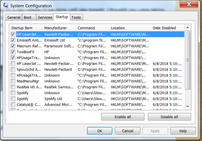

      Looks like you have set things up to start FireFox automatically on startup–hope you did that on purpose.
      No- Firefox starts using an icon in the tray.  I have not set up anything to run at startup beyond what’s needed to boot up.
      • #340693
        I’m a little confused. You reported earlier that
        I’m seeing Vista boot to the desktop and then to Firefox almost “instantly” while W7 takes maybe ½ minute (not timed) to show the desktop and maybe ¾- 1 full minute to open FF.
        If it’s not Firefox starting up automatically, then are you manually opening Firefox as soon as possible after Vista boots up? If you are not opening Firefox manually, then something is causing it to open without your specific input.

      So, let’s look at the Disk Management screenshots for a moment:
      (Remember, you can click on the screenshots to get a larger image view.)
      Vista-Disk-Management
      This is the Vista Disk Management screenshot. The two red arrows show Disk 0, and Disk 1. So, just as an FYI, Microsoft usually (but not always) starts disk numbering at zero (0). When be look at the Macrium Image Backup summary page shortly, you will see that the disk numbering starts at one (1). That can throw some folks off because it’s not the *same*.
      Also, when we look at the next screenshot of the Win7 Disk Management, the two disks will be in the reverse order–just represents a different sort order from one OS to another–the Vista OS and the Win7 OSs are separate from one another–not merged. Again, don’t let it throw you off.
      The two blue arrows–one pointing to *System* and the other to *Boot*. For unexplained reasons, these two terms mean the opposite of what you would expect–this is just Microsoft *speak* and we all have to deal with it! *System* means that the boot files are located here. On a *typical* Windows installation, usually the *System* label is found on a small partition at the beginning of the HDD–see the small box at the beginning of the Disk 1 that says 39 MB–that’s where I would have expected to see *System*. So, Dell has chosen to use a *non-standard* setup. (By the way, that 39 MB partition is labeled differently in the Macrium Image Formation summary–it’s the *DellUtility* partition there–we will look at that screenshot shortly. And the *Boot* label means that the operating system files are located here–you would think that would be labeled *System* wouldn’t you?
      And the green arrows–the only *Active* partition is the Vista *OS (C:)* partition–the Win7 partition *(F:)* does not have the *Active* label. When your system boots, it has to find the *Active* partition in order to boot successfully, because that’s were the boot files are located.
      Now, onto the Win7 Disk Management:
      Win7-Disk-Management
      So the red arrows show again the two separate HDDs, but now the listing of the partitions have been switched. Again, not a big deal–just a confusion factor.
      Blue arrows: the one pointing to the 39 MB partition in Disk 0 is labeled up in the top portion of the Disk Management with the Red Box around it as *OEM* Partition–again, it will be labeled *DellUtility* in the Macrium screenshot.
      The blue arrow pointing to *System* in the 3rd partition (the *OS (D:)*–the Vista OS partition) of Disk 0 indicates that the boot files are in that partition. And the blue arrow pointing to *Boot* in Disk 1 shows that the OS files are located there for the Win7 OS.
      Green arrows–two of them have the label *Not Active* to emphasize that the Win7 OS located on *C:* is not the active partition. The *Active* partition has to be where the boot files are located–and we have previously determined that they are on the Vista HDD, and now specifically on the OS *System* partition (i.e. the *OS (D:)* partition.
      So, onto the Macrium Image Summary page:
      Macrium-Image-Backup-Summary
      So, notice that the top disk is *Disk 1*, and the next one down is *Disk 2*–the numbering is different from Microsoft’s numbering.
      The first two red arrows on Disk 1 point to the first partition on the Vista HDD, and point out that the label is now *DellUtility*, and is the 39 MB partition. And the third arrow in Disk 1 points out that the *OS (D:)* partition is the *Active* partition.
      The final red arrow on Disk 2 points out that there is no *Active* designation for the Win7 partition (the *(C:)* partition), the only partition on the Win7 HDD.
      Questions?

      @ Slowpoke47
      One last bit of housekeeping–in the BIOS screenshots you posted, this one has me wondering:
      HDD-Priority-List-In-BIOS
      The 1st HDD in the Priority list is your Win7 HDD, and the 2nd drive listed is the Vista drive.
      If you recall, when looking at the Disk Management screenshots, the actual Active boot drive is the Vista drive. Once the boot files are read from the Vista partition, the system then switches over to the Win7 partition to run the Win7 OS:
      Win7-Disk-Management-1
      So, the HDD disk priority setting ends up creating this in the *Boot Priority* listing:
      Boot-Settings-Priority
      Which is *technically* wrong. But, your system seems to be by-passing that incorrect setting.
      So, my question(s) is/are: did you change the HDD Priority listing either when you first installed the new HDD and installed the Linux OS. After that, when you found out that your Win7 would not boot, did you reset that BIOS setting again? When you wanted your Win7 HDD to boot to Win7 OS, did you change that BIOS setting.
      Reason for questions–did your shut down freezing began after you installed the new HDD and the Linux OS, and after you made any changes to the HDD priority list in the BIOS (if in fact you did)?
      Until we successfully switch the bootloader from the Vista HDD to the Win7 HDD, I would like to have you go into the BIOS and set that HDD Prioity list to your Vista HDD being 1st, and the Win7 HDD being 2nd. (And, let’s see if your shut down freezes are effected in any way.)

    • #341224
      No, I was not even aware of HDD priorities
      Not sure- this could be.  I’ve been manipulating so many items last couple of weeks ago that I can’t say.  FWIW, when doing the Disk Management s/shot yesterday, the shutdown hung up when closing Vista.  But yesterday p.m. and earlier today in W7, shutdown was slightly sluggish but completed.
    • #341228
      NightOwl wrote: NightOwl wrote: I would like you to consider naming, or if already named, re-naming your various partitions so they have *descriptive* names that are *memorable*. So for instance, here’s a screen shoot you posted previously in this thread: You seemed hesitant to do this. Is there a problem of understanding how to do this?
      I see that Start>Computer gives me the option to rename partitions on a drop-down menu from a rt.-click.  Any naming suggestions?
      • #341281
        @slowpoke47, just to make sure that we know exactly what you’re looking at, are you looking at the “Rename” option in the drop-down menu that appears when you have Windows Explorer open and you right-click on a drive (C:, D:, etc.)? See the screenshot below:
        Renaming-drives
        If this is the sort of thing that you are looking at, then like @nightowl I recommend that you give the Vista drive and its associated recovery partition names that clearly indicate what they are. Assuming that the Vista drive is C: and its recovery drive is D:, for example, you could name them “Vista” and “Vista Recovery.” You could name the Windows 7 drive “Windows 7.” (It doesn’t pay to get clever or creative with the names when the goal is to easily tell what’s what.  🙂 )
        There is no need to type in the drive letters. For better or worse, Windows will assign the letters after you’re done typing and hit Enter. You will (probably) be asked for  Administrator permission to do this, and then you’ll be back at the drive naming box where you might have to retype the name you want, and then hit Enter.
    • #341306

      Looking back at the Disk Management s/shots, if we accept that a given disk that shows the same GB figures (581.48 for example) in both s/shots is in fact the same disk, called out as C: in Vista and D: in W7, how does that affect the renaming in W7?  Do I go back into Vista and give that volume the same name?
      EDIT- and, does that drive represent the entire OS, data files, system files, etc.?
      • #341318
        @slowpoke47, we’ve established upthread that the 581GB drive (actually, partition) contains the Vista OS, and that the 298GB drive contains your Windows 7 OS. The drive lettering will be taken care of (in a confusing manner) by Windows; so what you need to make sure of is that you give each drive a name that corresponds to the OS that’s on it.
        I am not certain that if (say) you rename the drives from within Vista, that the names will persist if you then boot into Windows 7. I believe the names will hold, but checking that is as simple as renaming the drives in one OS and then rebooting into the other OS to see what happened to the drive names. If the names don’t hold, you could always rename the drives from within that other OS too and then both Vista and 7 will have the same names for the same drives. (The drive letters are a different matter…)
        And to answer your question–yes, each drive contains everything that pertains to the OS that is on it: system files, personal data, and so forth. The only exception is the boot sector, which while residing on your Vista disk also contains the boot info for Windows 7. We’ll be seeking to take care of that later on, so that you can boot into Windows 7 without need of the Vista disk.
    • #341336
      Thanks.  Looks like I should go into Start>Computer in W7 and rename the smaller one Win7 and the larger one Vista- yes?
      I’m assuming it doesn’t matter that we’re looking at two separate physical hard drives here, (not actually partitions)?
      I’ll be away from the PC in about ½ hour and then out of town until tomorrow afternoon.
      • #341345
        That’s right.
        You got it. It doesn’t matter.
        While you’re at it, it’s a good idea to also rename the Recovery drive by adding “Vista” to the name, so that there can be no mistaking as to which OS it’s a recovery drive for.
    • #341354
      That’s right.
      You got it. It doesn’t matter. While you’re at it, it’s a good idea to also rename the Recovery drive by adding “Vista” to the name, so that there can be no mistaking as to which OS it’s a recovery drive for.
      Thank you- this is now done.  Not able to continue here until tomorrow mid-afternoon
      So, *naming* is going to be a *personal* preference–whatever works for you. I think your names should clearly tell you what you are looking at. Because Windows will give the various partitions a drive letter that many not match up when you switch which OS you are using, I like to include the drive letter a partition would be if I was using that partition with it’s native drive letter assignment. (There’s a reason Window has to mix the drive letters up–when booted to the Win7 OS, you can’t give the partition that has the Win7 OS on it the drive letter *C:/*, and the Vista OS partition that same drive letter–it has to have a different one–so it was given the drive letter *D:\*. And that same logic occurred when the Vista OS was booted to–the Vista OS partition was give the drive letter *C:\*, so the Win7 partition could not also be assigned that same drive letter–so it was given *F:\*.
      So I like to put in the native drive letter for that partition if I was booted to the OS on that HDD–so my suggestions:
      Vista HDD:
      *C-Vista OS* for what was originally just *OS*
      *D-Vista Recovery* for what was originally just *Recovery*
      *Vista DellUtility* for what was originally just *DellUtility*–this partition does not get a drive letter assigned either when Vista is booted or when Win7 is booted–it’s technically a partition the average user is not supposed to have access to and having no drive letter prevents inadvertent access by an average user–but as you can see, it is *visible* to Disk Management and the Macrium imaging software.
      On the Win7 HDD:
      *C-Win7* for what originally did not have a name
      Whatever you name a partition, it will be *sticky* and follow that partition to whatever OS you are booted to. If you initially name it in Win7, you will be able to see that same name when you are booted to Vista, or when you are booted to the Macrium Rescue Media. You do not have to *rename* it in any other OS. But, if you were to rename it in Vista (you will be able to do that just like you did it in Win7), then that *new name* will follow it to whatever OS you boot, and the name stays the same until you *rename* again, if you are so inclined
      So, the above paragraph should answer this question.
      I’m not sure what you mean by this. It very much *matters*! You have two HDDs, the larger one is your Vista HDD, and it has 3 partitions on it. And the other smaller HDD is your Win7 HDD and has only a single partition on it. You need to be aware of those distinctions, especially when doing imaging creating an image backup, and performing restores of image files! You will be *lost* if you do not have an awareness of your system layout (2 HDDs), and the layout on the individual HDDs (single or multiple partitions).
      That’s an important observation. In addition to partition names, you can also keep track of things using the partition sizes, or the entire HDD disk size. It’s not a bad idea to record those numbers on paper so you can refer to them when booted to the Macrim Rescue Media, and if you are unsure which drive or partition you’re looking at.
      Vista HDD:
      total size: 596.17 GB
      three partitions: DellUtility size: 39 MB, Recovery size 14.65 GB, OS size 581.48
      Win7 HDD:
      total size: 298.09 GB
      one partition: (un-named?) 298.09 GB
      Just to recap:
      Looks like you have named the partitions on the Vista HDD and Win7 HDD–take a new screenshot of the Disk Management readout to show us what the HDDs now show.
      Did you create a Win7 Repair Disc?
      Did you create a Win7 Password Reset floppy disk or flash/thumb drive disk? (If you use a password to access your system after booting.)
      Did you go to the BIOS and switch the HDD priority from the Win7 HDD being first to the Vista HDD being first? (Have you shut down since making that change? Did it make any difference to the system freezing during shutdown? Keep tabs on that for the next day or two, and let us know if there’s any change in shutdown behavior.
      More to come in a little while …

      @ Slowpoke
      Now, let’s proceed …
      So, you’re probably saying *What the heck is this all about?! I just want to make my Win7 boot independent from my Vista HDD!*
      Well, the answer is there is probably an easy way to accomplish the change to the bootloader to accomplish what you desire. But, I’m not able to *guarantee* that everything will work out! There could be a *gotcha* that will bite us in the butt! That being said, I want you to have the necessary tools to hopefully recover without too much angst should something go wrong.
      Secondly, you need to know that the two following statements are very different from each other:
      1. A imaging program such as Macrium with a stated option of “Repair the boot files if unable to boot*.
      2. Move the boot files from one partition to another, or move the boot files from one hard drive (HDD) to another HDD, and be able to boot from that other partition or HDD.
      If you make an image of a whole HDD or of a partition only, and then restore that whole HDD image or partition image to the same original HDD, there is almost never a boot problem. That makes it easy!
      But, if you restore your image to a *new* HDD, there is almost always a boot problem. This occurs because of the way the Microsoft default HDD identification is implemented in its boot files. Microsoft uses disk identifier IDs which are dependent on the disk ID plus the partition ID, and ….? whatever else Microsoft uses. It’s not important how Microsoft comes up with the ID–what’s important is that any *new* HDD will have a different disk identifier. And, the boot files do not update *automatically*! And there’s the rub–if the boot files are looking for the previous disk identifier, and the new HDD has a new disk identifier, then the boot file will not *find* that new HDD and will report a *boot failure* of some sort.
      So, we have to able to *fix* the boot files in order to able to boot, i.e. fix the boot failure. This basically is copying the new HDD identifier to the boot loader files so they once again match. This is what the *boot repair* function is all about in the Macrium Rescue Media. But, I have not used the Macrium boot repair, and I’ve not seen others who have reported success using it. So, I’d rather use a known emergency repair software–and that is the Win7 Repair Disc that I had you create. Microsoft made the bootloader file system that you are using now, it seems logical that the best tool to repair a boot failure problem should also be Microsoft–make sense?
      So, the Win7 Repair Disc is almost the same as the Macrim Rescue Media–they are both based on the Microsoft WinPE bootable emergency boot media. So, I want you to practice booting to the Win7 Repair Disc so you become familiar with it:

      @ Cybertooth
      Ultimately, of course, it’s a matter of preference and what best suits the way the particular user’s mind works. Slowpoke47 will find out.
      Yes–exactly what I meant here:
      I’m not suggesting @ Slowpoke do it *my way* or *your way*–it just has to be consistent and clear to the individual user what’s going on.
      The *confusion factor* is there either way–it’s just which way one designates the partition names that makes sense to the user. Note: The actual drive letters that the OS has assigned will be listed, regardless of what name has been used in the partition name.
    • #341703
      I asked this yesterday only in reference to changing the names of the drives, when Cybertooth mentioned naming partitions.
      Start-Computer-s-shot-3-14-19
      Repair disc is made.  We do not use a password on this PC, so presumably, floppy (or etc) not needed.

      BIOS will not allow boot order to be changed- see photo.
      IMG_0853
      Error message generated by selecting Vista drive and pressing “enter.”

      Disk Management screenshot, just taken:
      Disk-Management-s-shot-3-14-19

      @ Slowpoke47
      I’m not sure that the photo indicates any problem. Need to highlight (select) the top *1st Drive* and then press *Enter*, and then see if it will allow you to highlight (select) your Vista HDD and again press *Enter*.
      If that does not work, highlight that *1st Drive*, and then press *Enter* and this time see if you can select *Disabled* , and see if your Win7 HDD is then listed as disabled, or the *1st Drive* is listed as disabled, and the *2nd Drive* is still listed as the Vista HDD.
      If that still does not work, head over to the Boot Settings and select the *3rd Boot Device* and press *Enter*. Does that option give you the chance to select your Vista HDD? If *Yes*, select your Vista HDD and press *Enter*.
      Exit the BIOS settings using *F10: Save & Exit Setup*
      If for any reason, you are unable to boot back to you Win7 OS, undo the BIOS changes made, use *F10: Save & Exit Setup*, and reboot to Win7.
      Report results here.
      • #341731
        Looking at Slowpoke47’s BIOS menu across the bottom, is it possible he might need to use the arrow keys to move the selected drive up or down, as the case may be?
        For example, he could select the 1st Drive by pressing Enter, and then hit the Down arrow key to move it down. Or select the 2nd Drive and hit the Up arrow key to move it up.
        It’s been a while since I went into a BIOS, but I have some vague recollection of having to do this sort of thing. (The recollection can be refreshed easily enough.  🙂  )
    • #341737

      I’ll try this again, but first, here’s what happened with the Repair Disc:
      With disc in drive, pressed power button on case to start.  Black screen, “Windows is loading files.”  Then- “Select Keyboard Method” (US) as you predicted. Next box shown here:
      IMG_0855
      Bottom option selected by default, but I selected the top option as in photo.  Selected “Next” then screen shown below appeared, as you predicted:
      IMG_0856
      So far, the results more or less match your description.  But clicking “Restart” here sends the system back to the beginning, “Windows is loading files” and the whole sequence detailed above repeats.  The second time clicked “Shutdown” which did happen, then restarted using power button on case.
    • #341741
      I know what your talking about–I have run across having to use the up and down arrows to move a selection. I think it has to actually say something to that effect i.e. *To move a selection* in that bottom row–otherwise I think the up/down arrows are to move to the next item to highlight it–then you can select it by pressing *Enter*.
    • #341744
      Yes- that’s the only way to make anything happen on these BIOS screens.  That’s how you make selections, then “Enter” to send the message to the system.

      @ Slowpoke47
      Your first screen shot obove:
      System Recovery Options
      The second sentence: *If your operating system isn’t listed, click Load Drivers and then install drivers for your hard disks.*
      As you can see, your Windows OSs were not listed in the empty white box.
      That would indicate that the Rescue Disk is unable to communicate with your HDDs through the hard drive controller. Unless you are using a third party hard drive controller, it is odd that the WinPE Rescue Media is unable to work correctly with your HDD controller. Are you aware of anything out of the ordinary regarding you hard drive hook up and controller as far as your system is concerned?
      Please post the Dell model number of your system–hopefully that will allow me to see its specifications and look for anything unusual.
      If the Repair Disc can not communicate with your HDDs, then it can not repair any startup problems that may occur.
      We can check your hardware, and the HDD controller drivers in *Device Manager*, but let’s finish up the other stuff first.
      I think Macrium Rescue Media was able to communicate with your HDDs–we will have to double check that now that we see this problem. But if the Macrium Rescue Media was able to communicate, then the Repair Disk should have been able to as well …. hmmmmm …. COMPUTERS!

      I’m not sure that the photo indicates any problem. Need to highlight (select) the top *1st Drive* and then press *Enter*, and then see if it will allow you to highlight (select) your Vista HDD and again press *Enter*. If that does not work, highlight that *1st Drive*, and then press *Enter* and this time see if you can select *Disabled* , and see if your Win7 HDD is then listed as disabled, or the *1st Drive* is listed as disabled, and the *2nd Drive* is still listed as the Vista HDD.
      Messed around with this and was able to select the Vista HDD, then F10, “save and exit.”  But the bootup sequence still showed the same black screen as before, with W7 as the default, highlighted in white.

      @ Slowpoke47
      I guess you don’t remember, I was wanting to change that setting in the BIOS to see if had any effect on your slow or frozen *shut down*.
      “*technically* wrong” was referring to the Win7 HDD being set as the boot HDD (1st in the priority list) when the Vista HDD has the *Active* setting and has the boot files on it. Your system was still booting successfully even with the *wrong* setting pointing to the Win7 HDD–making the setting *right* (having the Vista HDD as the 1st HDD in the Priority List) should not have changed anything about the boot process that was already ignoring any *wrong* setting in the BIOS!
      Let me know if your shut down function shows any change in behavior.

      I just thought the default boot order would now highlight Vista.
      Ah, okay, I see what you were thinking.
      The BIOS setting will not change any software settings! The boot loader that allows you to select either the Win7 or Vista OS is a software that stands alone, and the BIOS will not change anything there. You can change the *Default* OS if you wanted to, to the Vista OS. I think I can show you how, but I think you want the Win7 to be the *default*–Yes?

      With W7 booted up, inserted the Repair Disc.  Nothing appeared on the screen.
      Start>Shut down>Restart went as expected (minute or two hung up in “shutting down” ) but then restarted,immediate black screen, “Windows is loading files” with a white bar graph across the bottom indicating progress.
      Pop-up box as before “System Recovery Options” “Select keyboard input method” as before. only choice is “US.” Clicked “next.”
      Same screen as yesterday with blank white field showing no OS’s.  Clicked “next.”
      Screen shows menu of options identical to yesterday’s.
      IMG_0856-1
      Only two options from here are Restart, which repeats all previous steps, or Shut down, which I chose.  Just restarted manually and removed the Repair Disc before it was seen by the PC.

      @ Slowpoke47
      Dang! Not what I hoped for.
      So, there’s still a chance we can work around this–we have not tried the *Win7 Installation Disc* yet.

        Start Windows 7 normally without the DVD in the drive and enter Disk Management.
        Right click Disk 1 and choose the shrink volume option. Try to shrink it by 500 MB. If successful you will end up with 500 MB of unallocated space on Disk 1.
        Right click that and create and format a new NTFS partition using all the space you just freed. Do not assign a drive letter or remove the letter if Windows adds one “right click on it”. Mark the partition as active “right click on it”. Ignore the it can not be used warning if you see it.
        How to Shrink a Hard Drive Volume in Windows.
        Post a screenshot when you have done this.

      • #342227
        but what do I have to do re “format”?
        NTFS is the file system used. On a small partition of 500 MB you also have the extra choice of the FAT32 file system. We need NTFS Windows might offer to format it for you. No need to reformat it then again.
        Do NOT Format WIN7 C:!!! Only create a new partition in the freed up unallocated space.
        W10&11 x64 Pro&Home
    • #342234
      New volume created, see s/shot.  Box on right generated via rt-click on new volume.  Not able to find where to mark as “active.”  No reformat needed.  No warnings generated.
      Disk-management-s-shot-3-16-19
      • #342237
        The screenshot shows the freed space 500 MB well done. But it does not show that you made a new partition into this freed space. Notice how it is still black and says unallocated.
        The device properties box you show has nothing to do with partitioning. It shows that the physical harddisk as a whole is correctly recognised by Windows and performing normal.
        Continue from here:
        If successful you will end up with 500 MB of unallocated space on Disk 1. Right click that and create and format a new NTFS partition using all the space you just freed. Do not assign a drive letter or remove the letter if Windows adds one “right click on it”. Mark the partition as active “right click on it”. Ignore the it can not be used warning if you see it.
        And I want a screenshot! I need to verify that you did it correctly. That the 500 MB is now a blue box with no drive letter assigned.
        W10&11 x64 Pro&Home

      • #342272
        Creating a new partition on the Win7 HDD is not hard. But, just look at all the steps that follow in the rest of that posting. I’m not even sure @ Slowpoke knows how to open a *Command* window–I have not asked him yet.
        Yes that is the bit that i dread because he will have to use the command prompt to tell the system the new partition is the one to boot from. Would you agree to let him only try a triple automated repair from the Windows 7 DVD with the Vista HDD detached once he has a working partition? We then forego any command use if that does not fix it and continue with your suggestion since I agree that that might be more suited for Slowpoke47.
        Also beware of Cybertooth suggestion which under the circumstances is not bad either. Slowpoke47 already stated he was capable of installing Linux.
        W10&11 x64 Pro&Home
    • #342268
      (Sorry for the delay) Just finished an 11 a.m.meeting that ran over 2 hours…
      Sinclair- Again attempted to follow your directions re the new partition, cannot find how to do that.  I did see the black, instead of blue, header but got stuck.  Rt-click on the new 500MB partition brings up a menu with two choices- “Properties” and “New Simple Volume Wizard.” Since you didn’t mention such, I didn’t pursue that Wizard.  Should I do that?
      New-Simple-Volume-Wizard
      • #342276
        Yes right click on the new 500 MB partition. Choose “New Simple Volume Wizard.” and follow it.
        Make sure it does not assign a drive letter or remove the letter if Windows adds one “right click the 500 MB again after the wizard completes to remove a letter if needed”.
        Slowpoke47 there was a bit of discussion about wetter you can handle all the steps and I agree with NightOwl that it might be a bit to much for you. So if you do not mind then we will use this partition as is and attempt an automated repair from DVD after you created it.
        I would like to see a screenshot of the created partition. After that you can then turn the computer off. Detach the Sata cable from the Vista HDD and boot from the Windows 7 DVD into system recovery options. There you choose the first blue line startup repair. Let it do its thing. Then reboot again with the DVD in the drive and do it all again. Reboot again after it finishes and do it a third time. Then remove the DVD and turn on the computer fingers crossed. If it does not boot reattach the Vista HDD Sata cable and all should be as you started.
        W10&11 x64 Pro&Home
      See s/shot.  Proceeding to the next steps.
      Disk-Mgmt-new-partition-3-16-19

      Did you do this test run–booting to Win7 OS, putting the Win7 Installation Disc in, and then doing a *Restart*, and booting from the Win7 Installation Disc.
      Was the white box populated with the Win7 and/or Vista Installed Windows OSs?
      It’s possible that I have this backwards. Maybe what needs to be done is boot from the OS that has the bootloader files on it! That would be the Vista HDD.
      So, if the above test run fails to have the Installed Windows show in the white box, try this:

      Did you do this test run–booting to Win7 OS, putting the Win7 Installation Disc in, and then doing a *Restart*, and booting from the Win7 Installation Disc. Was the white box populated with the Win7 and/or Vista Installed Windows OSs?
      White box still empty.

      Are you still getting a bootup screen that allows you to select either the Win7 or Vista HDD (of course, Vista will not boot if you have removed the drive). Did you test to see if you *could* boot the Vista OS if you wanted/needed to?
      It would be helpful to have a screen shot of your Disk Management in Win7 to see what changes have taken place.
      And, if you have not yet removed the Vista HDD, and you can boot to that OS–a screenshot of Disk Management for the Vista HDD, again to see what changes have taken place.

      If you have not removed it yet, before removing the Vista HDD–look in the BIOS to see what the current HDD Boot Priority is.
      After removing the Vista HDD, re-boot and again enter the BIOS and check once more what the HDD Boot Priority show as.
      Be interesting to hear what that currently is, and if it changed *automatically* after all the *Startup Repairs* and the removal of the Vista HDD.

      On bootup, both OS’s are still there.  After all that we just went through, I’m not too anxious to reconnect Vista- just in case there is some sort of “cross-contamination” (substitute your own term there).  I’m just not that curious.
      Disk-Mgmt-W7-only
      • #342359
        From the screenshot, it looks like the boot files got written to the main Windows 7 partition and not to the small “New Volume” partition. The C: drive description gives it as both “System” and “Boot.”
        This is only an observation, not a suggestion to do anything about it. Although if everything continues to work well, eventually you may want to eliminate that small partition as a housekeeping measure. I don’t think there is any risk in doing this, although I’m willing to be corrected if that assessment is wrong.

      @ Slowpoke If you have not removed it yet, before removing the Vista HDD–look in the BIOS to see what the current HDD Boot Priority is. After removing the Vista HDD, re-boot and again enter the BIOS and check once more what the HDD Boot Priority show as. Be interesting to hear what that currently is, and if it changed *automatically* after all the *Startup Repairs* and the removal of the Vista HDD.
      Just restarted- Vista is gone from any screen in BIOS but still shows as an option on startup as a remnant of the dual boot config.  (W7 is the only HDD currently connected.)  But an interesting detail- in that dual-boot selection screen, both Vista and 7 are shown, as stated, but each has an additional notation after it, (recovered).

      @ Slowpoke47
      Looking at your *Windows Boot Manager* screenshot, it looks like you should be able to press F8 from that boot menu screen, and that should give you the option to boot to *Safe Mode*.
      Windows-Boot-Manager
      The top option in the next screen for *Safe Mode* should be just *Safe Mode* without any added options–select that.
      Look around the *Safe Mode* screen once you have successfully booted to *Safe Mode*, press the Start button and look at the menus there–just spend a little time in *Safe Mode*. Then, shut down. What you want to determine is can you shut down without any significant delay or freezing of the process.
      Maybe re-boot to *Safe Mode* several times to determine if there is a pattern to what happens when you shut down from *Safe Mode*.
      Once you re-boot, and simply select your Win7 boot option, you will be booted to your normal Win7 OS.
    • #343179

    • #343428
      Started in Safe Mode as advised by NightOwl.
      First and second times- looked around, etc., allowed time to be sure fully booted up.  Shut down sequence- “Logging off” took about ½ sec.  “Shutting down” lasted less than 5 sec, computer shut down.
      Third time- into Safe Mode as before, this time tried to open Firefox.  Did not open- message for all tabs and b/marked links- “Server not found.”  Closed out of Firefox, waited about 10 sec., started shutdown procedure, went exactly as above.
      Fourth time- as above, except tried to open Chrome.  Message “No Internet.”  Shutdown went just like three previous.
      NightOwl calls for step-by-step, so I’ll wait for the ok to start Cybertooth’s list.

      After *Start > Computer*, right button mouse click on the drive and then select *Properties* at the bottom of the list of actions that show up. A screen shot of the *Properties* screen would be helpful.
    • #343525

      Before moving onto the next item–a new question: What settings do you have set for Windows Update? I see you state that you are following the Group B method for updating, but what is the setting you have set in Windows Update? A screen shot would be great.
      Screenshot attached- I don’t like things that happen automatically, “for my convenience.”  One important attribute of my “fun” car is a clutch pedal- I prefer to choose my own gear, as well.Windows-Update-s-shot
    • #343668
      @ Slowpoke47
      Screenshot attached
      Okay, next question–are you currently getting the monthly notifications when the new updates are available, as per your setting: *Check for updates, but let me choose whether to download and install them*?
      The reason for these questions about Windows Update–I had a problem with shut down that occurred, not in Win7, but my old WinXP OS. Somehow the Windows Update files and setting became *corrupted* in some fashion that I have no knowledge. But, the result was that when I would attempt to shut down, it took a long time–often 10-15 minutes. I could see the hard drive activity light flashing regularly–so I knew something was going on, but after you are already at the *Windows is Shutting Down* screen, there was no way to see what program(s) were still running, and possibly responsible for the delayed shut down. Eventually, the system would shut down–no *freezes* like you have been having.
      I trouble shot that issue for *weeks* and could find nothing wrong with anything! But, after 6-8 weeks, I noticed that I was no longer getting my monthly notifications about there being new updates to be downloaded and installed.
      I had learned some time prior to this problem, that the best way to initially troubleshoot a Windows Update problem was to *Disable* Windows Update, then *Re-enable* Windows Update, then re-boot. This procedure causes Windows Update to uninstall the program files that run Windows Update, and then re-loads those files and refreshes the settings, etc.
      Long story, short–after re-booting, Windows Update showed me the new Updates waiting to be downloaded and installed–and, my shut down problem was now gone! So, there was something about the Windows Update problem that was putting Windows into a scanning and wait mode that had something to do with Windows Update and the problems it was having …
      So, humor me, please–it’s easy and fast to do–will cause no harm–and we will find out if there’s any associated problem here: Go to that Windows Update *Change Settings* page that you made the screenshot of above. In the *Important Updates* section, the dropdown list, select *Never check for updates (not recommended)*, and then press *OK*. After the activity stops, go back to that dropdown list and re-enable your Windows Update with the same previous setting: *Check for updates, but let me choose whether to download and install them*. And, again, press *OK*.
      Now shut down–this first shut down likely will not have the new settings necessarily in place and functioning–you have to re-boot and try the shut down again to see if the behavior is any different. Shut down again and see if there is still the delay and/or freeze.
      Test it–and see what happens. Report results.

      Solution 4 – Perform a clean boot
      This trouble shooting procedure probably has the most likely chance of finding the problem. The *msconfig.exe* trouble shooting program is an excellent tool for finding startup or shut down issues.
      Let’s begin: Using *Start > search box*, type in *msconfig*–you should get this result:
      msconfig
      Select the listed program link, and you should get this:
      System-Configuration
      Now, select the *Startup Tab*, and you should get this:
      Startup-Tab
      I have a total of 15 programs listed in my *Startup Tab*. How many programs do you have listed?
      On this Tab, you can make changes to which programs will be started the next time you re-boot your machine. You can *uncheck* individual programs (see arrow on left hand side), or you have the option to *Disable all* (see arrow down at bottom).
      The programs in this *Startup Tab* are *unnecessary*–i.e. they are not *required* in any way in order for Windows to boot up to it’s normal desktop display. These *startup programs* are from the applications you have installed–and the applications have placed these startup programs in this *que* to be started automatically when you bootup your system.
      When you uncheck a box for a particular item, you are not *uninstalling* that program. Your selection is *temporary*–it will remain unchecked until you re-check it, but unchecking it is in no way *destructive*–re-checking it will bring it back the same as it had been previously. So, *unchecking* temporarily *disables* that program, and nothing more.
      So how does one use this program to hunt down a misbehaving program? You can find different ways to approach it, but the technique I learned, and it seems to work well, is to disable the first half of the Startup items:
      Disable-Half-of-Startup
      Then, press the *Apply* button. Now, upon your next start, those programs that you have disabled will not be loaded. If one of them is responsible for your delayed and/or frozen shut down problem, it should not occur on the next shutdown.
      A couple notes: 1. The *slow shut down*–you have previously said this problem has been around for possibly *months*. FYI–it’s not uncommon for Windows OSs to slow down, both while using, and during shut down–if you have a lot to programs that get loaded by the Startup function. Over time, as programs are added, so too does the list of Startup programs increase–this will slow your system down! (So, we need to see how many Startup programs you have listed in that *Startup Tab*.), and 2. If I remember correctly, you said the *freezing* on shut down is a more recent problem–maybe the last 2-3 months–yes? These two issues may be completely separate issues, and caused by different problems. So, here’s another question–in the last couple months, did you install any new programs just prior to noticing the shut down *freezes*? I think you have mentioned the *Veeam* backup program. Any others that you recall? Any *recent* programs will have to get more scrutiny than programs that have been around for *ages* without the *freezing* problem.
      So, to continue, after pressing the *Apply* button, you then press the *OK* button. You will get a screen telling you that you have to *Restart* for your selections to take effect. Close out any other running programs, and the click the *Start > Restart* option. (Don’t worry if your Shutdown freezes–it will not effect the results of our setup and/or testing of the shutdown the next re-boot cycle.)
      (The next few instructions are from memory, and I know the gist of the steps, but not the exact details. I’m going to reboot and test the steps out and will update these instructions accordingly–and I am unable to post any more screen shots in this reply (limit of 4 max!) so I’ll do some screen shots upon reboot.)
      Upon restarting, the *msconfig* is going to *pop up* telling you are in troubleshooting mode using the *msconfig* program, click *OK* and the *msconfig* program will be loaded automatically so if there are any new changes that you want to make, you can do it now if needed. Just *minimize* the *msconfig* program, use the Windows OS for posting your replies here, and eventually you will test the shut down to see if disabling that first half of the *Startup Programs* had any effect.
      Edit by NightOwl: Well, I guess I was remembering my old WinXP *msconfig* behaviors! In Win7, upon reboot, nothing happened. I then started the *msconfig* program manually to check things out–I’ll post results in a future post later today.
      You may notice that certain programs do not appear to be present. If they were part of the list of *Startup Programs* that you *disabled*–well, they will not show up *automatically*. Most likely, you can, if necessary, load those programs *manually* from the *Start > All Programs* listing of installed programs. But, loading them will *muddy* the results of your next shut down testing–so do the shutdown testing first.
      Questions? Concerns?
      Report results that you have to this point.

      @ Slowpoke47
      This was the only item in the All Programs>Startup folder
      Just FYI, this Startup Folder is mostly *old school* method for having a program *start up* when you *boot up* your system–mostly used with WinXP era programs, or older.
      Most newer programs load their programs from *Registry* entries, and the average user has no awareness of what’s going on in the background.
      Interested in how these statistics compare with others’ experiences.
      You already *know* how quickly *shut down* can go–remember booting to *Safe Mode*, and how fast the shut down went there? That’s the *target* you can aim for! If you control how many programs, that are running in the background, need to be shut down by limiting how many there are, you should have fairly fast shut downs.
      I find that if I click “shut down” right after doing that, I get the Task Host Window, “Force shutdown” routine
      This is NOT a typical shut down process that *most* people see when shutting down. This suggests that there is a program that is not behaving quite as it should. And, if possible, if you eliminate or alter this program’s behavior, you could get faster, and less problems with your shut down.
      Have you run the *msconfig.exe* program, and looked at the *Startup* tab as outlined in this post:
      There was a question:
      Screen shots of the programs listed in the *Startup* tab would be helpful. You might have to take one screen shot, then scroll down to get the next *batch* of listed programs, and maybe even a third or more screen shots to finally get all the programs recorded in the screen shots. Post them here so we can look at them.
      You have caught me on a day where I’ll be gone until late tonight. I thought you were taking a *break* from trouble shooting for awhile–so I did not rush to complete my trouble shooting steps for the *msconfig.exe* program. I will continue that outline, starting maybe tonight, or more likely tomorrow.
      Run *msconfig.exe*, answer my question, and give us some screen shots–and we will proceed.

    • #349797
      Screenshots today of msconfig-startup screen.  Notice that many items are still unchecked from a previous attempt to address this issue almost a year ago (with help here at that time).  I could next follow NightOwl’s suggestion and swap the “enabled/disabled” status of the items on the list, but I’ll wait for an ok or other comment first.
      Startup-screenshot-4-8-19
