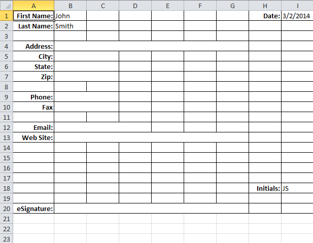

    • #1471209
      Derf,
      I put together a sample sheet with data. I am not sure of what kind of data you are using but the following code will adapt. The borders will be created just prior to printing based on the data on the sheet.
      HTH,
      Maud
      Sample sheet
      38157-Print1
      If you want all the cells in the range of data:
      38158-Print2
      then use this code:
      Code:
      Private Sub Workbook_BeforePrint(Cancel As Boolean)
          Cells.Borders.LineStyle = xlNone
          ActiveSheet.UsedRange.Select
          Selection.Borders.LineStyle = xlContinuous
          [a1].Select
      End Sub
      If you want just the cells with data to have borders:
      38159-Print3
      then use this code:
      Code:
          Dim rng As Range
          Dim cell As Range
          Set rng = ActiveSheet.UsedRange
          For Each cell In rng
              If Not IsEmpty(cell) Then
                  cell.Borders.LineStyle = xlContinuous
              End If
          Next cell
      End Sub
      These codes will add or remove borders in accordance with the cells that have data.
