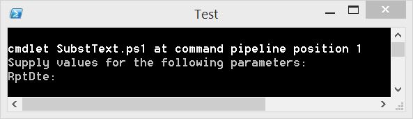

      If you place it in a directory called Scripts you can create a shortcut with the following target.
      C:WINDOWSsystem32WindowsPowerShellv1.0powershell.exe G:BEKDocsScriptsSubstText.ps1
      Replacing the part in bold to match your machine.
      The program will prompt you for the date:
      36141-PS
      If you haven’t used powershell before you will need to start powershell manually and enter this command:
      Set-ExecutionPolicy = RemoteSigned
      You can check it was successful by entering Get-ExecutionPolicy
      36142-SubstText
