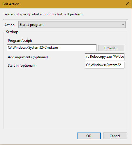

    • #1547720
      I have the Robocopy command line setup (and tested) in Task Scheduler to run at 3:00 AM. The Task Scheduler Action tab looks like this:
      43289-Robocopy-Task
      The arguments are
      /c Robocopy “V:UsersbbearrenDocuments” “A:OneDriveDocuments” /MIR /XJD /R:1 /W:1 /MT:64 /V /NP /LOG+:V:UsersbbearrenDesktopRoboCopy.log
      The /c switch is used to close the Command Console when the task is completed.
