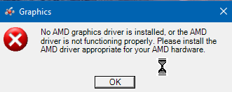

    On every system start/logon I get this message:
    46622-ScreenShot002
    IMHO an annoyance.

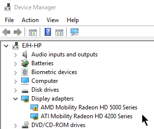

    Device manager shows two (?) display adapters:
    46623-ScreenShot003
    I seriously doubt that the machine has two display adapters despite what device manager says…

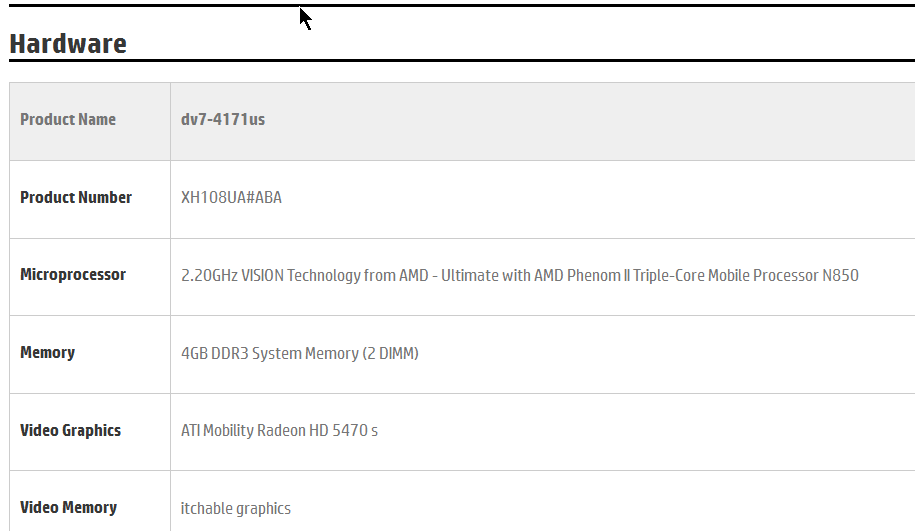

    HP’s documentation shows that there should be only one adapter:
    46624-ScreenShot004

      AMD’s Catalyst driver package does not solve it either. I assume that HP has a tiny tweak so that AMD drivers don’t work. Running AMD Catalyst software ends in an unspecified error message, the link to explanations is completely dead.

      AMD does have Win 10 drivers for the HD 5000 series http://www.amd.com/en-us/markets/game/downloads
      As the alert is on the 5000, download those drivers to see if you get the same error.

        … Both msinfo32 and dxdiag don’t give anything specific for my single Intel adapter, but dxdiag may tell you if there are any problems under the Display tab.
        Sudo15, thanks a bunch. Now it’s getting crazy, msinfo32 and dxdiag agree with each other that the machine has an AMD HD 4800 display adapter installed.

      IMO, you need a foolproof way of determining what actual GPU hardware you have. It all starts with that. Some of the HP laptops have stickers on them advertising the GPU hardware they incorporate. That’s one place to start.
      Another possibility is the HP web site. HP has pretty good model/feature descriptions on their site, from what I remember.
