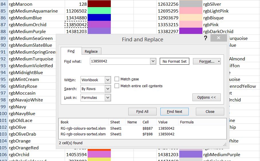

      I just found something very interesting!
      Neither my solution nor Maud’s solution generates all the codes!
      I modified my workbook to included Maud’s nice code on sheet 3 (FullSpectrum) and include the lookup of the color names. Not many matched. :confused:
      So I did a little investigating.
      My code only came up with 62 of the color names (when I adjusted the code for exact matches only).
      Maud’s code only came up with 23.
      While Zeddy’s table had 142 names?
      I picked a color at random and did a whole workbook search and it only showed up on Sheet1 (Zeddy’s sheet).
      41021-Colors
      Now I’m even more confused than I was before. :cheers:
