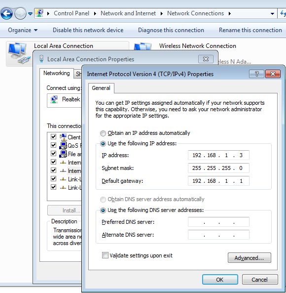

              …Is there a way to manually change the IP address?…
              You could try setting a “static IP”:
              42829-Static_IP
              But for “IP address” use one that is unlikely to cause a conflict; if your other connected devices are using 192.168.1.2 through to say 192.168.1.10 then you could assign 192.168.1.20
              “Default gateway” is the network address of your router; you can look that up on one of your other PCs.
              However, it does seem very strange that the PC has been set to “Obtain an IP address automatically” yet was trying to use IPv4 Address 192.168.0.2 and Default Gateway 192.168.0.1
              Have you checked that the network cable is connected to the router correctly?
              42829-Static_IP
              Yes check that! There should (on most setups be an led indicator light on BOTH end of the Ethernet cable. If not that would be the point of trouble shooting.
              After manually setting the IP info you could reboot and ping your router (default gateway) or one of the other computers on your network.
