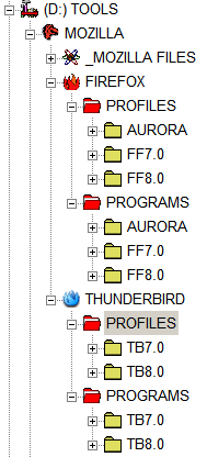

              Ray …
              I spelled out the long procedure because I wanted to make sure anyone could do it. Personally, I use the much shorter procedure you describe, except that I have to rename the files (WinZipPro 14.5 doesn’t recognize .xpi files, although newer versions might).
              FWIW, I used to use MozBackup, but found that it’s much easier to simply copy the desired profile folder to a different location. Because all of my FF versions use identical profiles (same is true for TB), the chances of losing info due to a munged profile are greatly reduced … simply delete the bad profile and copy a good one in its place.
              Also, because I use a partitioned hard drive, I do NOT use the standard installation when installing FF or TB. Using the custom installation allows me to install FF and TB to designated folders on my D: partition. Using the profile managers allows me to install the profile folders in the same location. The ONLY aspects of either program that must be on the C: partition are the respective profiles.ini files.
              29149-mozilla
