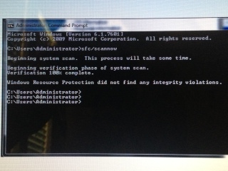

          Hello.. I know this is a “Long Shot” ..but i would try it …
          1. Right click on the devices with the “Exclamation Mark” and click to either disable or uninstall each..
          2. From an “Elevated Command Prompt” ( right click run as administrator) input “sfc /scannow” No quotes and space after sfc..
          3. Reboot and post back with results :cheers: Regards Fred

            Hey man –
            Thanks for your suggestion! I followed your suggestions and then rebooted, but nothing. Devices are still inoperable.. 34325-software

              Ethan,
              Hello… What did (if anything) the “sfc /scannow ” find?
              Regards Fred
            • #1400165
              Ethan,
              Regards Fred
              Ah, sorry about that!
              It did not find any “integrity violations”.. 34326-photo
