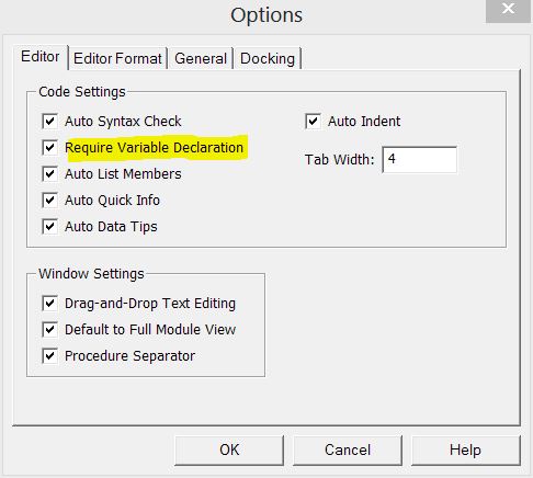

      I’m a programmer and have been doing and teaching it for 40+ years now {and still learning}. So now you know where I’m coming from let me explain why Double. It is good programming practice to Declare all your variables (in the case of VBA that means the DIM command) and arguments in your functions/sub routines. In this case the as double declares (dims) the return value (answer) of the function and allows for large numbers with decimal places. If you don’t do this VBA will use a type of Variant which will work but is much less efficient and also will not allow for the VBA compiler to catch errors at the compilation stage which may then show up later in the execution stage as #Value or #N/A errors.
      I make it a practice to always include Option Explicit at the top of all my modules. (BTW – there is an option in the VBE to make this happen automatically).
      34877-VBA-Options
      This forces you to declare (dim) all of your variables which can take the guess work out of things when you are trying to find out (debug) why things are not working properly. So if I re-did your code the way I would do it it would look like this.
