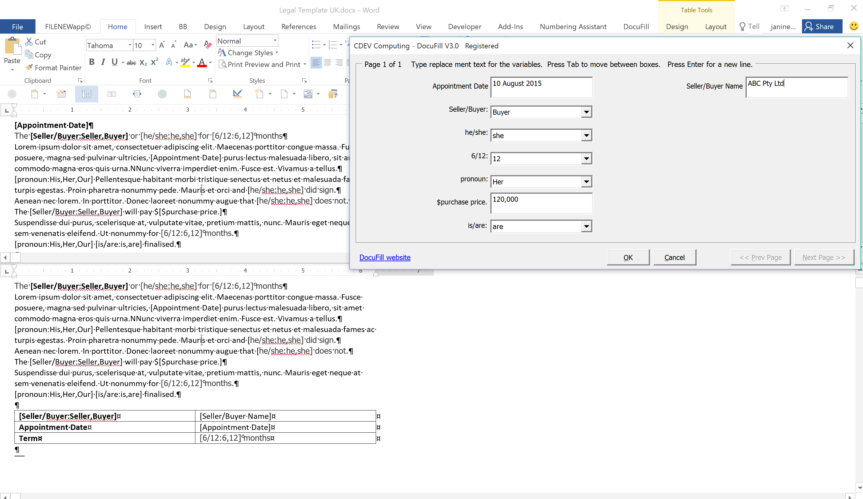

AskWoody LoungerAugust 8, 2015 at 7:46 pm #1521082Hi laughsalot (what else can one do)!
F11 is out of date you would move to Content Controls but below addin DocuFill from CDEV Computing is excellent and means only the authors (fee earners) need to fill in the information ONCE or you can fill it in from the handwriting on the pdf you receive.
You can spend $US39 and become the Word Developer by using an addin from CDEV a UK business run by Chris Devrell. His addin Docufill will resolve the fee earner’s horror. What version of Word do you use? The fee earners can do the work themselves and you Shelley can just check the document and its formatting etc. Or if they still handwrite edits and pdf them to you, you can fill in the variables using this program – better yet buy your own copy and enjoy laughingalot for pleasure not out of wanting to pull your hair out (ouch)!
Surely you can give yourself a leg up to Word Developer and get the fee earners to authorise a few copies of the program (remember to laughalot)!
To Set-up documents/templates:
Open the document/template that you wish to have DocuFill operate against. Enclose each occurrence of a variable in square brackets Eg: [Client Name].You can have variables in the Header and Footer areas of a document.
It is a good idea to make the variables descriptive so rather than say [date] use [date of appointment]
This is an example of marked-up text:
[Client Name] of [Client Address] signed the contract on [signing date].And it is required that the user type his/her/their/its etc …. DocuFill has the facility to offer a drop-down list instead of a text box. To set this up, type the variable in the document together with the required list options in the following format (note the colon and commas)
[pnoun: his, her, their, its].
This will then appear as follows in the DocuFill dialog
pnoun: his
her
their
itsThe below image is what the dialog window that pops up to allow you to fill in the variables in square brackets. There is an options setting for dropdown choices and how they are typed in the Word document. Download the trial and open a Word File New document from the template and it will show all text in square brackets. You hit next page to move through to the end of the variables. If the variable is more than once in the template you insert the same variable in all those places and it is filled in.
41627-Docufill-Sample-legal-document
This is an excellent program Shelley. Chris does bespoke work for many companies including Microsoft so I urge you to give the program a try.

AskWoody_MVPAugust 8, 2015 at 10:00 pm #1521092F11 is out of date you would move to Content Controls
That’s hardly an accurate characterisation of F11, which works in all Word versions for moving between fields.
As for content controls, they don’t work on Macs or with Word versions prior to Word 2007 – and even content control checkboxes don’t work with Word 2007. Even if that were not a concern, you can’t perform automatic calculations or generate conditional output with content controls unless the document is a macro-enabled one and, since you can’t ensure macros would be enabled by the client (especially given the potential for macros to be used to do harm), one can’t even ensure such a document would be functional.
Since the documents are for use by clients who may be using Macs or PCs with Word 2007 & earlier, it’s best to stick with features supported by both platforms and all versions. Hence formfields and other fields.
As for DocuFill, that appears to be a US-centric product, but Shelley is in the UK. And, since the documents need to be sent to clients for them to fill in, I’d question whether DocuFill is applicable for this even in the US.
