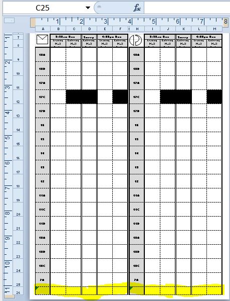

    • #1469936
      cremorneguy,
      Ok here’s a possible solution.
      Observations:
      1. Your test file has Custom Margins set to 0 and I worked from there though I don’t know of any printer that can print to the size of the page.
      2. The 8 Header rows use up approximately 1.5″ which would seem to leave 9.5″ of usable space however, I found a useable space of 10″ still leaves a little unused space at the bottom (highlighted in yellow in the graphic). I’ve tried to craft the code so it is easy for your to change the parameters and experiment for best results in your environment. Personally, I wouldn’t try to use all the space as the calculations could in some circumstances cause the data area to overflow the page size.
      3. The macro is designed to work on the Active Sheet! It would be advisable to limit the macro to only work on the sheet it is designed for as follows:

      Sample Results:
      38086-resizerows
      Code:
