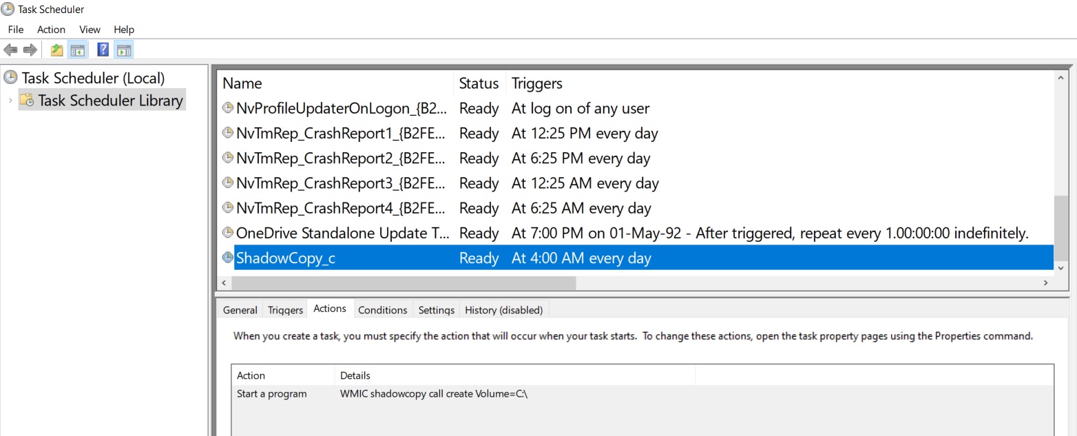

      I checked the Volume Shadow Copy in Services.  It is set to run Automatic, yet from what I saw in Services… it wasn’t actually “running”.  in the left side of the pane, when you click on Volume Shadow Copy, it says “start the service”.
      I have created a daily schedule for Shadow Copy :
      Configure Shadow Copy For Windows 10
      SCopy
      SCopy2
      • #2251112
        Hi.  Did you have to go into the registry and modify it to schedule the Shadow Copy?
    • #2251901
      No need for registry modification.
