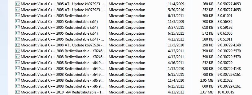

      I seem to have a large number of them as well:
      28229-Visual-C

      Hi Ted,
      You’re welcome. Your list actually looks as big as mine :).
