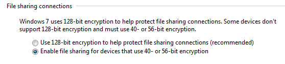

AskWoody LoungerJanuary 6, 2010 at 7:46 pm #1195927When you go to home group in control panel, you can view the homegroup password. Do this for the PC #1 you set your homegroup up on. write down the password or if the PC’s are close together leave this password open on PC #1. Then go to second PC and choose join homegroup name from PC #1. You will have to set the password the same as the first PC. Once you do both PC’s are in the same homegroup. When you have a file or folder you want to share, simply right click and choose share with and set your shares. It really is simple.

AskWoody LoungerMarch 26, 2011 at 5:20 pm #1273590So how does one set up Workgroup Sharing? Sounds like a good deal, but I can’t find my way there.
All help appreciated.
Check out this article from Fred Langaon Win 7 workgroup settings
