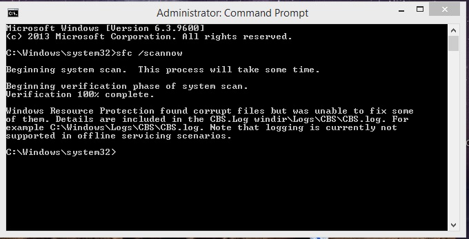

      Thanks, Drew. I may just dial them up. But I ran sfc again, and it wanted a restart again, so after the restart (which took a while), I ran it yet again, and it returned:
      40650-sfc-result
      I opened CBS.log, but haven’t made heads or tails out of it. Is there a link that tells what to look for? I saw a line mentioning AMD, but I have an Intel system. The CLI session said that the log would tell me which dll file I need to reinstall manually, but I don’t see one in plain English. (CBS_log.txt attached.)
      I have to do more research, I guess. I may try some of the other suggested answers as well.
      Thanks,
      Steve

      Can you also check to see if KB3022345 has been installed ?
      If it is, that could be responsible for the irreparable files and you may have to go back two restore points before the WUs as I did for the sfc /scannow to repair them.
      Running the /restorehealth command to see what it reports will also help and if that comes up clean, then run the sfc /scannow again.
