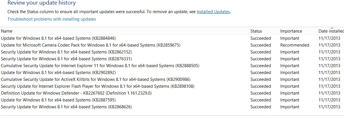

    Prior to the Windows 8.1 ISO upgrade install I made certain that there were no updates available in WU, and this
    is what updates were available in WU after 8.1 installation;
    35525-Untitled1
    (Note the Dates)
