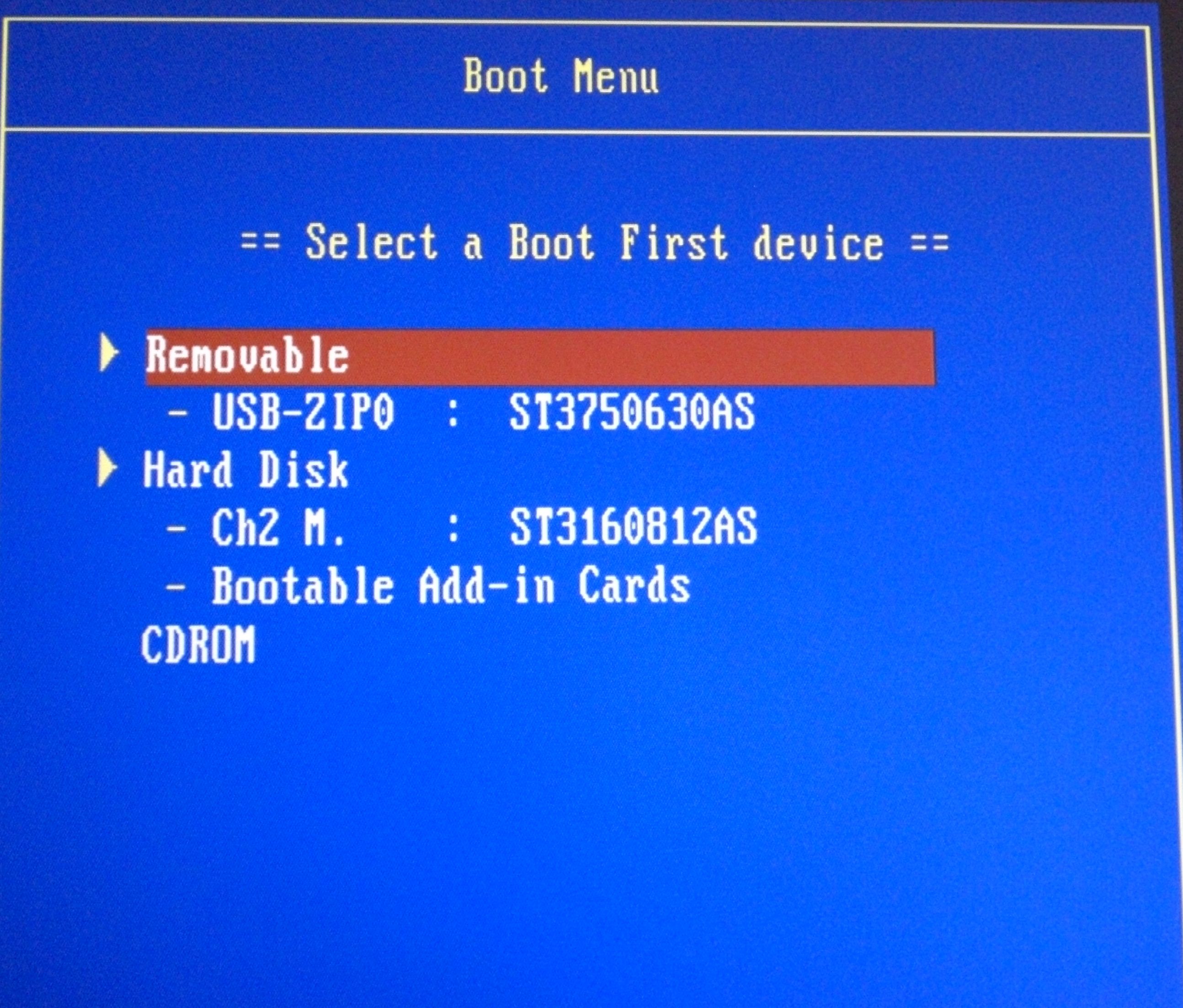

          Hallo again PlainFred, I have tried to get into Safe Mode but the screen which appears is one I’ve never seen before. If I just click on it it takes me straight back to the XP OS installation even though I have removed the disc from the DVD drive. I’ve taken a photo of the Boot Menu as I can’t PrintScreen, hope it’s all right to attach it. Also I’ve taken a photo of the missing file screen, you will notice that the CDROM0 has changed to CDROM1, and that the i386 does appear to be 1386 although the “1” is different just a straight line.
          Not sure if the photos have attached, plase let me know if not.

            • #1403615
              Sorry, PlainFred, the only screen which appears is the Boot Menu as shown above – no sign of Safe Mode
            • #1403626
              pompey,
              Hello… “Boot menu” is a choice along with “BIOS configuration”… both are not what you are looking for …On some OS’s you enter these by hitting “ESC” or F-11, or some other “F #” key… You enter “Safe Mode” after the BIOS Screen makes it’s appearance.. Then start hitting the F-8. Sounds like you enter your BIOS with the F-8 …never heard of that …can’t say why …One other question …What happens when your in the “Boot Screen” if you choose the HD option and hit enter? Regards Fred

      Seems that the images were too large, trying again34501-CIMG256134502-CIMG2560alt

      Hi Fred, If I choose the HD option, the selection slips down to Ch2 M. ST3160812AS. I didn’t think the Bootable Add-in Cards was relevant, so clicked on Ch2 M. etc and this just went back to the XP OS installation setup complete with the missing file screen even though there is no CD in the tray. I feel if I could cancel this operation we might get somewhere.
      Incidentally I have found the way into BIOS is to use the delete button, don’t know if that’s any help.
      Is it possible to get into Safe Mode via a command prompt?

        pompey,
        Hello… You need to get into Safe Mode at boot time ..I know of no other way … you then can choose from the selection using the UpDown arrows “Safe Mode with Command Prompt”. I have seen (some PC’s) that you have to choose an administrator account to enter “Safe Mode” Either way, once in there are about a dozen options….Regards Fred

          At last – it’s F5. I phoned Medion the computer builder and was told that if F8 doesn’t work, to try F5, and that has worked. I clicked on Safe Mode which produced a long list of System32 files, but there’s more than will fit on one screen and I cannot scroll using the up/down keys to see if i386 is there. That then disappears and another screen appears with details of the XP OS across the top (curiously this quotes SP2 whereas I have SP3 installed). In the centre is another message which reads “Windows XP Setup cannot run under Safemode. Setup will restart now.”
          This then goes into the same installation operation with the missing ASMS file.
          I have also tried Safemode with Command Prompt with excatly the same result.
