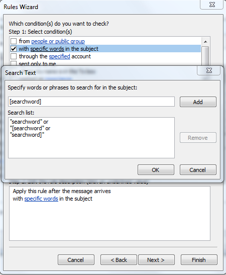

    • #1353102
      Would this work?
      Create a rule that would match any of the following in the subject:
      searchword
      [searchword
      searchword]
      [searchword]
      32220-olrule
      Not the most elegant of solutions but may do what you want.
    • #1353177
      Glad to be of help Chuck.
      Remember to select stop processing any more rules in the rule you create.
