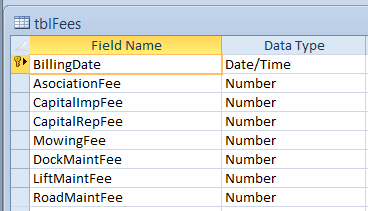

    Here's the Table structure (with the exception of the last item which was what I was trying to add when I noticed the new error but I restored backups to make sure that wasn't causing the problem but didn't take a new screen capture.
    43236-tblFeesStructure
    I've done quite a bit of googling with out any results that work.
