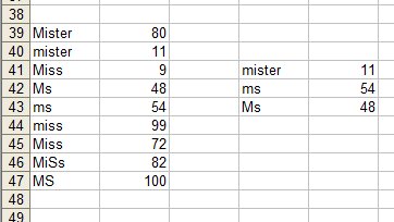

AskWoody LoungerNovember 2, 2011 at 11:58 am in reply to: Case-sensitve VLOOKUP not working with Lower Case #1305059Difficult to know without the data.
The formula you have is looking for the value in E41, so IF you want to look for the value in E1 the formula in C1 ought to be=INDEX(AcType!$B$1:$B$4178,MATCH(TRUE,EXACT(E1,Ac Type!$A$1:$A$4178),0)) (Entered with SHIFT CTRL and ENTER)
This should look for a case sensitive match with the value in E1
Looking for a match in A1:A4178 on the AcType sheet, and bringing back the corresponding value from B1:B4178 on the AcType sheet.#N/A implies it cannot find a match.
It can be as simple as an extra space in the data in E1

AskWoody LoungerNovember 2, 2011 at 11:45 am in reply to: Case-sensitve VLOOKUP not working with Lower Case #1305057Have a look at the updated attached file.

AskWoody LoungerNovember 2, 2011 at 11:34 am in reply to: Case-sensitve VLOOKUP not working with Lower Case #1305054The module is not quite right as far as I can see.
It ought to be
Code:Function CaseVLook(compare_value, table_array As Range, _ Optional col_index As Integer = 1) Dim c As Range Dim rngColumn1 As Range Application.Volatile 'This line was wrong Set rngColumn1 = table_array.Columns(1) CaseVLook = "Not Found" 'Loop first column For Each c In rngColumn1.Cells If c.Value = compare_value Then CaseVLook = c.Offset(0, col_index).Value Exit For End If Next c End Function
Mind you that is for my data below …..

AskWoody LoungerNovember 2, 2011 at 11:22 am in reply to: Case-sensitve VLOOKUP not working with Lower Case #1305052You can try it with Exact and using Match and Index
I have attached an example file
