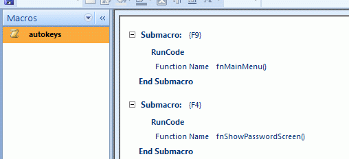

AskWoody LoungerHey All,
I’ve been googling and reading and I still can’t figure out how to simply assign a keyboard shortcut to run a VBA routine in Access 2010. This was a piece of cake in 2003 with AutoKeys macro.
I am not aware of anything changing with this from 2003. I still just use an AutoKeys macro like I used to. (But I never use accdb format. Does that affect things?)
