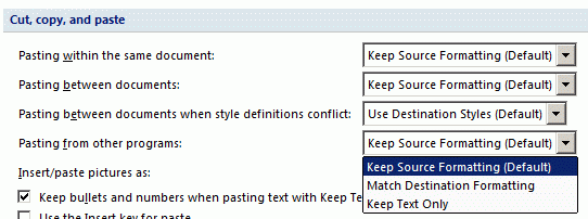

AskWoody LoungerI don’t have access to 2003 at the moment, but in 2007 (and 2010) there is an option that controls this:
WSjohnhutchison
AskWoody LoungerYou many need to change
And also perhaps add an x to the end of this.

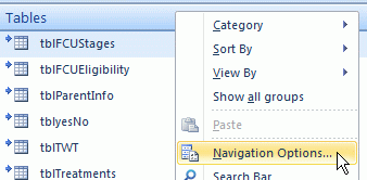

Here is a workaround. Change the Row Source Type of your combo to Value List then use the following code to fill the values from the query. The code goes in the On Load event of the form. Don’t repeat the Private Sub Form_Load() and the End sub.Code:Private Sub Form_Load() Dim strTableList As String Dim db As DAO.Database Dim rs As DAO.Recordset Set db = CurrentDb Set rs = db.OpenRecordset(“qryTables”, dbOpenSnapshot) If Not rs.EOF Then rs.MoveFirst Do While Not rs.EOF strTableList = strTableList & rs(“Name”) & “;” rs.MoveNext Loop strTableList = Left(strTableList, Len(strTableList) – 1) ‘ Substitute the name of your combo box Me.Combotables.RowSource = strTableList End If ‘ Clean up rs.Close Set rs = Nothing Set db = Nothing End Sub
Also, the first Record is showing f_4F9F14BD3CC24FC9BD1EEA8B81596AC8_Data” instead of a actual table
Don’t know what to make of that. Get your database to show you Hidden and System objects, so you can see the full list of Tables.
Right Click on the top of the Navigation Bar and choose Navigation Options.
30397-NavOptions
Then tick the boxes for Show Hidden Objects and Show System Objects. See what you can find.
Look in MySysObjects (That is the table the query uses.) -

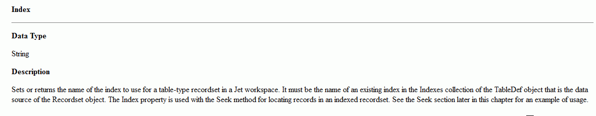

AskWoody LoungerI don’t know whether this helps you (or me)?
The Seek method is very fast because it uses an Index. The FindFirst method just works through the Recordset until it finds something.So the first line of your Seek code specified the Index to use:
rst.Index = “PrimaryKey”
The Index Property of a Recordset is only available for Table Type Recordsets.
