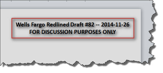

      I still have one issue, but I think I’ve resolved just about all my other issues. Here is what my draft stamp looks like now:
      38530-TextBox2
      Here is my code:

      The only thing I haven’t been able to figure out in formatting the text in the text box. I can insert one font & point size, but I can’t adjust these for the second line. It may look fine the way it is, but if there’s a way to adjust it, I’d like to know for future reference. Thanks.

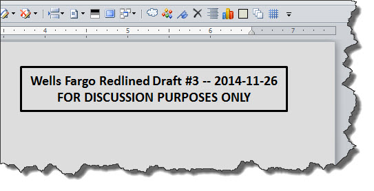

      Thanks for the suggestions, Andrew. I may have mislead you (and others). I don’t want the draft stamp in the header. That’s what I do now, just with text. I want to convert to using a floating text box on the first page only. I have continued to poke around the web searching for macros with TextFrame in them and found some good stuff. This is what my draft stamp looks like so far:
      38527-DraftStamp
      This is the code I’ve come up with so far:

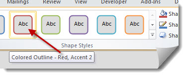

      This is far from final. I’m working with my header macro code and some of that is mostly inapplicable. I probably need to go get my code that saves a bookmark, goes to the top of the file, inserts the textbox, and then jumps back to the bookmark, but I’ll add that later.
      In any event, what I can’t figure out is how to select the formatting options for the text box. I’ve been using TextFrame, but maybe I need to use Shapes per your code? I want it to have a red border and be shaded. Is there a way to select this formatting option from the ribbon bar, maybe with some type of “style” selection?
      38528-BoxStyle
      And what about shadow? I’d like to apply this shadow:
      38529-Shadow
      I’m going to keep poking around, but if you have any quick suggestions, that would be great.

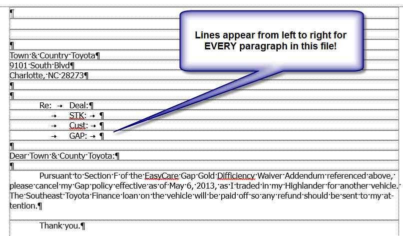

      Great. That helps. Although I like to have the outside of the text boundaries appear (which is how it works in Word 2010). Oh well. Thanks. -Rich
    • in reply to: Word 2013 – Display Formatting Marks #1463609
      Both docs were open in Word 2013 when I took the screen shots. The “lines” appear after EVERY hard return in the “squiggly” screen shot. They might be “text boundaries”; I don’t know for sure. Turning off “text boundaries” doesn’t seem to be an option. I only have this issue in Word 2013. If I open these files in Word 2012, they both look the same when I turn on all display formatting options. I know that the red squiggly lines are spell check lines. If they are text boundaries, how do I turn those off? Any ideas? And why don’t they show in the other file? The .DOC file (the Union County doc) is open in compatibility mode. The other file is a DOCX file so it opens normally. If I re-save the DOC file as a DOCX file, the lines between EVERY paragraph reappear. Why? Is this some “function” of Word 2013 to display DOCX files? If so, it is really announying (but then again when has MS really cared if it annoys people). See add’l screen shots. Anyway, any thoughts on how to turn these off??
      37619-Squiggly-Lines-Display237620-Non-Squiggly-Lines-Display2
