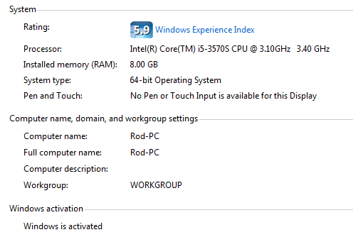

WSrstew
AskWoody LoungerHave a look at that Properties page again and you’ll see the OS at the top of the page, which was what Joe wanted you check.
Here is the whole screen (except the Windows product ID at the bottom):
46210-Basic-System-Info-12-13-16It is exactly what I thought it was.
rstew
WSrstew
AskWoody LoungerThe pic in Post #8 shows quite clearly that it is Win 7 Home Premium SP1 and the memory is showing as 8GB – a 32 bit system would only recognize a max of 4GB.
Here is a snip of the system information screen, as suggested.
46209-System-Info-12-13-16rstew

WSrstew
AskWoody Loungercmptrgy;
Here is a snip attached from System Info. It clearly shows to be an x64 system.
46205-System-Info-Snip-12-12-16This was installed using a non-OEM W7 HP x64 SP-1 DVD purchased about 2 years ago.
The new W7 Pro x 64 product key was purchased locally from a reputable source and is known to be valid. The install DVD was burned from a downloaded ISO file some time ago, and I have used it before.
But what difference does all this make? The screen popup shown in my OP occurs right after the “accept license terms and conditions screen”, way before any loading of files actually starts, and way before the point where it asks to register and activate.rstew

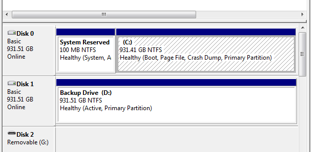

WSrstew
AskWoody LoungerI reckon it’s because you made it active so Macrium thinks it’s a system disk.
Delete the partition and re-create it without making it active.cheers, Paul
I wondered about that. So I deleted the partition, then reformatted it as a non active partition. It now shows as Healthy Partition. Guess what; still no joy with Macrium. it can’t find D: as a destination drive. I clicked on the 3 dots per Browni’s suggestion and that only shows folders on the C: drive as options. Yippee.
(It is an image I am trying to create; not a disk to disk copy.)Then I uninstalled this new version of Macrium 5.3.7310 and installed the Jan 2015 version 5.3.7256 just in case. Still no joy; exactly the same as the newer version.
So I am done fiddling with Macrium. It just won’t play nicely no matter what.
I will stick with Seagate Disk Wizard which at least seems to do what I need.Thanks for all the help and suggestions.
Over and out.
rstew -
WSrstew
AskWoody LoungerSo as requested here is a snip from Disk Manager showing the two drives after merging the partitions and reformatting D: Looks pretty clean, right?
46196-Disk-Manager-SnipAnd here is a snip from Macrium as I tried to set up an image backup to D:. D: drive only appears as a source drive; never as a destination option for some reason. And the reason it now shows as having data on it is that I finally got sick of messing with Macrium and used Seagate Disk Wizard to create an image, using its backup option. Way more user friendly. It also allows incremental backups daily, weekly, monthly, etc. Now, would it work if I needed it to restore from? Who knows? Hopefully.
46197-Macrium-SnipAnybody got any idea what’s going on with Macrium? This is the latest update version by the way. Maybe they have removed the option to image to a HDD for the free version?
