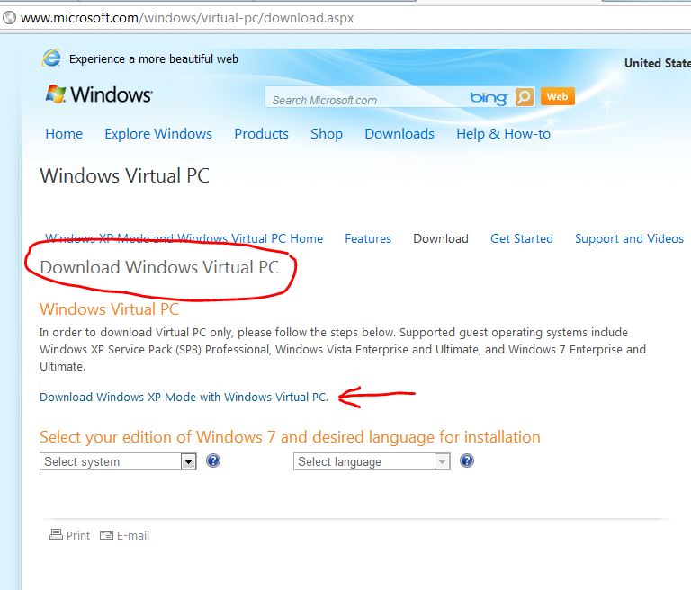

AskWoody LoungerYes, it surprised me too, I thought XPMode was only for Pro, Enterprise and Ultimate.
I admit, it’s quite confusing on that page, and it took me a couple of attempts to download the right update package, but XP Mode is not available in Win7 HP. You can download that update, but when you install it fails with an error referring to incorrect version of OS.
In the attached image, you have to click on the link next to my arrow to toggle the download to only Virtual PC rather that Virtual PC with XP Mode. In that image, I’ve already toggled it to just Virtual PC as can be seen by the circled headline.
So, Virtual PC is available as a stand alone application for Win7 HP, similar to VirtualBox, whereas it becomes integrated as XP Mode in the business class versions of Pro, Enterprise and Ultimate.
Nevertheless, I still use Virtual Box because I had specific compatibility issues with Virtual PC in the past – it might be better now, but better the devil you know etc………
