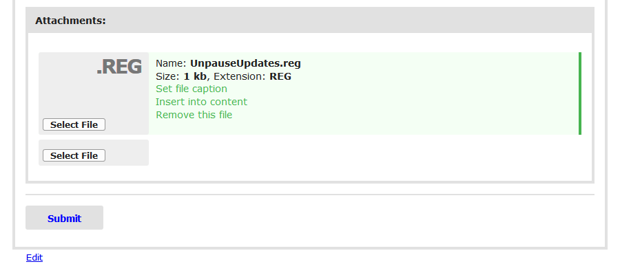

      I understand what @geekdom is trying to say and here’s an image of me trying to “attach” a .reg file to help you understand what’s happening.
      PostAttachmentScreen
      It I click Submit without choosing one of the options displayed to the right of the .reg file I selected, the .reg file does not show up as an attachment to my post.
      However, if I select the Insert into content option, it places a link to the attached .reg file in the post that allows it to be downloaded just like any other attachment (which means the S/W is saving it into the media library)
      In both cases, I still see the “Sorry, you are not allowed to upload this file type.” error message after posting my reply.
