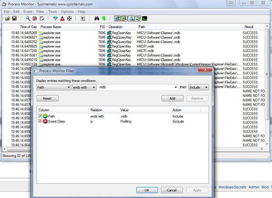

I suggest that you use a tool such as Sysinternal’s Process Monitor and then add a filter for process name, using your program’s name. You can also add a filter for path ending with .mdb or .accdb. Like that you can see what files are accessed by the program and find out why your data is not being updated.

AskWoody LoungerFebruary 20, 2012 at 5:07 am #1320541Start Process Monitor. It will look something like this:
30127-ProcMon1Click the diamond icon (if you hover it, it will display filter) and you get something like this:
Now add a filter. If you are looking for a .mdb file, this is what you need to add
For the left dropdown choose Path, then ends with then add .mdb and then at the right, then Include, as the picture shows.
Click the Add button, then the Apply button and the window will show you the filtered list:You can click the Ok button and have a look to see if you find the .mdb in question, or just try adding another condition to the filter. If you know the program’s name, you can try to add a line for that too. Options can be:
Process name, from the first dropdown, begins with, add the name of the program and then choose Include at the far right dropdown. Click the Add button, then the Apply button and then OK.
At any time you can bring the filter window back on and click one the lines and then click the Remove button, to remove it, and then add a new line, to look for a different extension (.accdb) or a different process name.
HTH

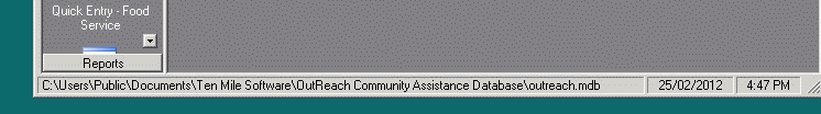

AskWoody LoungerFebruary 25, 2012 at 12:05 am #1321776I have installed the application and done a little bit of testing.
The program use an mdb data file, and by default this is called Outreach. At the foot of the main screen it display the name and path of the data file being used. The screen shot below displays the default location.
When I run the application I do see an ldb file created in that location. The Date Last Modified is updated when I modify any data through the application.
When I close the application and open the mdb via Access I do see the data I have just entered via the application. I can change the data in Access, then see the changes in the application.
I can make a copy of the mdb and move it to another location and see all the data, either via Acces or the application.
This is not much help to you. It tells you that my copy is doing what you want your copy to do.
My only conclusion is that you have created so many copies of the mdb file that you are getting confused about what one to use when.
[*]If you open the mdb in Access and don’t see the data you have just entered via the application, then the data file you open in Access is not the same one you were using.
[*]If you the open the mdb in Access and do see the data you have just entered via the application, but not older data, then you were using the wrong data file when you last used the application.If you exit the application without closing the data file, it automatically reopens the same data file next time. That seems like a good safety feature to me, once you have really determined what is the correct data file.
I acknowledge that I have only entered a little bit of test data, but I can’t think of any other explanation for what is happening to you.
