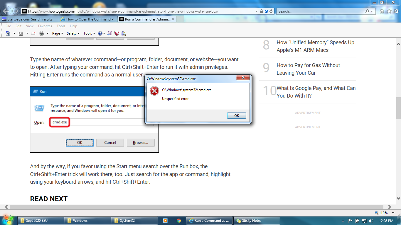

      Thanks, just tried running cmd.exe with Ctrl+Shift+Enter from Win+R and it’s opening the regular CLI without asking for Administrator rights.
      I also tried another way, suggested in How-To Geek, to do Ctrl+Shift+Enter from the Start menu, and received a different error:

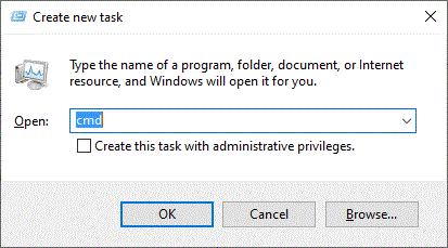

      Cybertooth – Two thoughts – and I just edited –
      1. Start Task Manager, click on the button at bottom to Show Processes from All Users (which I think means you are running Task Manager as an Admin), click on File, click on Run new task, type in cmd, and (if you see it) check the box for Run as Administrator.  The picture below is from my Win 10, not my 7, so I’m not sure it will be the same for your 7, but I just checked on a Win 7 macxhine and it looks the same.
      Task-Manager-File-Run-cmd
      2.  Go to Installed Updates and UNinstall the most recent updates.  Then see if you can start cmd and run sfc /scannow, etc.

    • #2316334
      Well, whaddaya know, running cmd.exe as Admin from Task Manager did not cause an error! <scratching head>

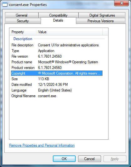

    • #2316610
      Consent.exe does show up in the right folder, although I can’t tell if it’s been corrupted.
      What is your level of consent? — C:\Windows\System32 –
      consent
      The General tab shows a size of: 113 KB (115,936 bytes)

              @Cybertooth
              Well, I’m now completely stumped … this IS a very interesting & challenging problem.
              SFC should have found/fixed any Windows OS file issues which I would expect to include the cmd.exe, consent.exe & appinfo.dll files.
              Safe mode ran fine so cmd.exe file is probably OK.
              UAC nor McAfee runs in safe mode so if SFC did check consent.exe & appinfo.dll and found no errors, I would suspect some other 3rd party program that interfaces with UAC the culprit with McAfee being the most likely.
              By the way, both consent.exe & appinfo.dll files are periodically updated by MS and if you search for either of these, you’ll find several versions of them in your Windows Winsxs folder under several subfolders with names starting with:
              “amd64_microsoft-windows-lua_31bf3856ad364e35_{version# & ID here}”
              My consent.exe version is 6.1.7601.24561 which I got when I installed the Oct 2020 updates on 10/24/2020.

              Besides the original (anti-malware) version of Windows Defender, the only other security software on that laptop is Malwarebytes Anti-Exploit. I can try uninstalling it if there’s a chance that it might be the culprit.
              UPDATE: I found the cause. It’s MBAE. When I opened the GUI, there was a button to “Stop Protection.” Rather than uninstalling the program, I decided to try that first, then went to open cmd.exe as Admin from the Start menu. Hitting the same button to restart its protection and then trying to launch cmd.exe with elevated rights, resulted in the same problem we’ve been seeing all along.
              The puzzling thing is, MBAE has been on this machine for years, since 2014 or so, and it had never given any grief. FWIW, it’s version 1.13.1.304.
              FURTHER UPDATE: This was reported as a bug in version 288 on the Malwarebytes forum here. Evidently, though, the bug wasn’t fixed in the next version.

      Why not just copy and paste cmd, consent and other relevant files from one of your working 7 machines into this one?
