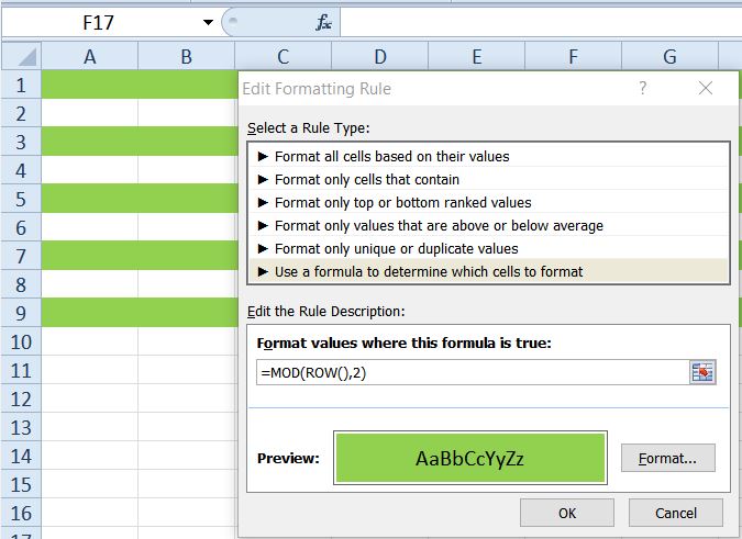

      FYI: the =1 & =0 in your formulas are not necessary since in Excel zero = False and everything is True. Mod(number,2) will return 0 or 1 thus being False or True respectively. I often use this feature to Green Stripe (or as we used to call it ETP Elephant Toilet Paper) a sheet as so:
      46874-ModZeddy

        Hi RG
        I needed two conditional formatting rules to get two different cell-colour backgrounds
        (bearing in mind that we also have the ‘grey’ rows in rows 57 to 61)
        So, you are correct..
        ..but, I still needed to differentiate between these two results in order to get the two different cell colours i.e. I could have used these two rules:
        Rule1:
        =AND(S6>0,G6>95000000,MOD(ROW(G6)) ‘for colour1 background
        Rule2:
        =AND(S6>0,G6>95000000,NOT(MOD(ROW(G6))) ‘colour2 background
        zeddy
