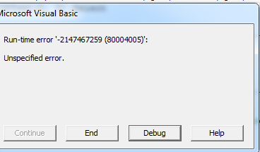

    I have a user From with 6 input boxes. One of those receives a strike price. If that price is lower than a the purchase price I want to tell the operator and then depending on the response move the focus back to the purchase price text box. This is th code
    Private Sub Opt5_Exit(ByVal Cancel As MSForms.ReturnBoolean)
    If Opt5.Value < Opt2.Value Then
    Response = MsgBox("The Strike Prices is lower than the Purchase Price is this correct", vbYesNo, "Check Strike Price")
    If Response = vbNo Then
    Opt2.SetFocus
    Cancel = True
    Exit Sub
    End If
    End If
    End Sub
    For some reason it asks the question twice even if I click No the first time and then I get an error at the Opt2.Setfocus command.
    This is the error message
    40018-Screen-Shot-2015-03-28-at-12.37.06-PM
    Any suggestions as to the solution greatly appreciated I have searched on line about moving the focus without any luck.
    Peter

    • #1497770
      Peter,
      Delete the Cancel=True line or change to Cancel=False for clarity. This sends the control back to the Opt5 control when you want focus to go to the Opt2 control. The Yes option should set the Cancel=True flag.
      • #1497772
        Thanks for that suggestion, there is not a yes option unless I should include an else option in the if then but if the test is passed I want to move on. Deleting the cancel = true for some reason moves the focus to a command button not the next text box.
        Take care
        Peter

      • #1497813
        RG Thank you
        Still no luck I changed your code to conform with my UserForm hopefully I did that correctly see below.

      • #1498141
        Hi Maud
        Thanks for the input tried that and it does not cycle twice as it did on exit but it still goes to the command button “Next Stock” bypassing the next text box Opt 6 which is what I would have thought it would have gone to had the set focus command not worked. If the strike price is greater than the purchase price then it does just tab to the Opt6. It’s got me beat,I can live with it just not what is needed, it could be the strike is wrong as opposed to the purchase price however I wanted to start ta the first one and work back down the form.
        Thanks again for your time
        Peter

        Peter,
        My apologies! I just realized the code I posted as working was Access NOT Excel! I don’t know why the Excel version doesn’t work but it doesn’t and I can’t get your file to work as it should nor can I get a test file of my own to work either. I’m going to have to give this some deep thought. Maybe someone else will chime in with something I’m missing. BTW: I found a label and a textbox on your form that were located off of the form the Top value was minus (TextBox1 & Label1). :cheers:
    • #1498227
      Peter,
      Just got it. I’ll be in touch. :cheers:
    • #1498241
      Peter,
      Ok I think I have the form working?
      What I did was to strip all the code that was not necessary to testing the form.
      I also completely redid the form and gave all the objects names so things are easier to understand when reading the code, e.g. tbStrikePrice vs Opt5).
      I’ve also changed some of the code (which of course you can change back if you don’t like it) which IMHO is easier to read and for the user to use.
      Test out the the file attached and see what you think.
      Test File: 40062-PeterFormTest-RG-
      Note if you like the changes you can Export the Form (it will take the form code with it) via the file menu in the VBE and then Import it into your file after deleting the old form. Of course you have to do a search and replace on the form name from old to new in your entire project.
