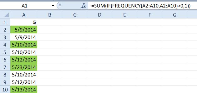

      If I understand your original post correctly this should do the trick.
      37115-unique

    • #1454492
      Beryl,
      I think this is an anomaly (unintended working of the function) as if you read the help file for the Frequency function it states that it has to be entered as an array formula. I did not do this.
      If you place your cursor on the formula then select from the Ribbon: Formulas->Evaluate Formula and then step through the formula you can see what happens.
      Frequency creates an array within the IF() part of the function that would look like this in my posted example {2;0;3;0;2;1;0;0;1;0}.
      You’ll notice there are 10 entries ( I would think there should only be 9 but I’m sure there is a reason for the 10th one) one for each of the cells in the range.
      The 1st entry shows that there are 2 entries for 5/9/14.
      The 2nd entry shows 0 since it is a duplicate and already counted.
      You can follow this logic down the line, with the exception of that extra one on the end.
      Take the next step in the evaluation and the entries are converted to True/False values where 0=False anything else = True (normal Excel behavior).
      The next step compares each entry in the array to see if it is greater than 0 and if so changes it to a 1 so you get {1;FALSE;1;FALSE;1;1;FALSE;FALSE;1;FALSE}.
      You could make this clearer by changing the formula to full IF syntax as: [noparse]=SUM(IF(FREQUENCY(A2:A10,A2:A10)>0,1,0))[/noparse]
      Which would yield {1;0;1;0;1;1;0;0;1;0} which should make things a little clearer.
      Finally, the 1’s are summed giving you the answer.
      I hope this makes it a bit clearer. :cheers:
