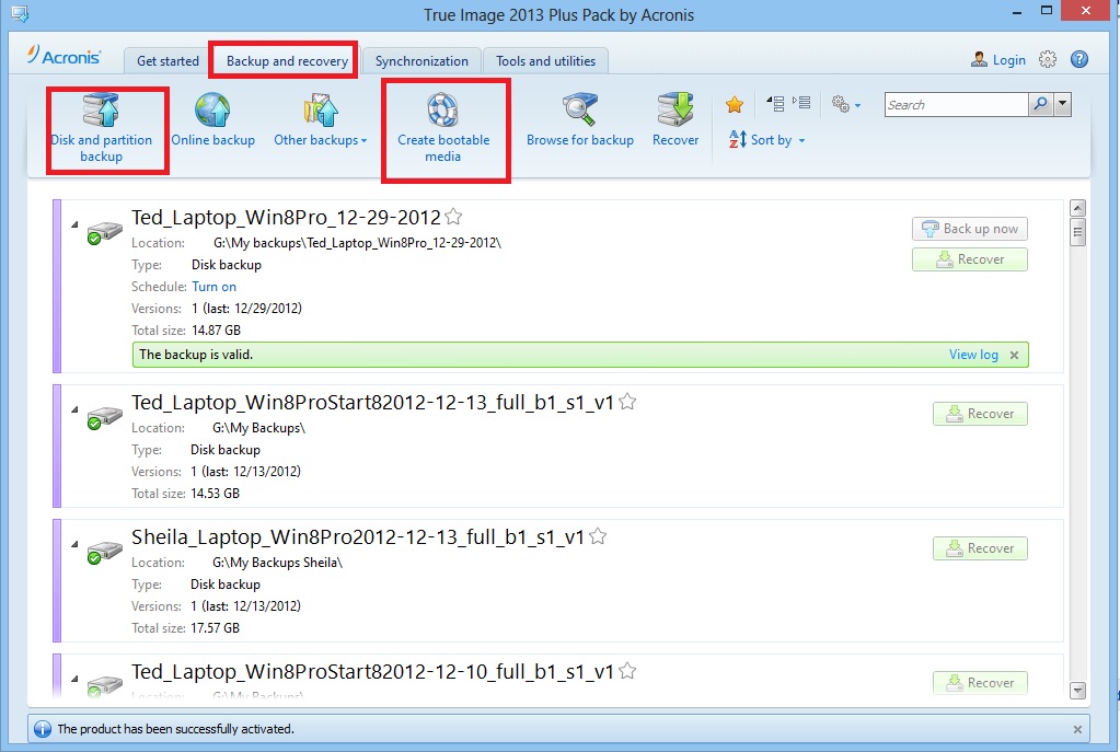

    • #1367804
      Phil,
      Let me try to show how easy Acronis True Image 2013can be. Download and install the trial edition. There is a blue Download Trial button.
      The first screen shows how to get started.
      32818-Screen1
      1) Choose the Backup and Recovery Tab
      2) On this tab there is a Create Bootable Media. This is Important, do it!
      3) Click on Disk and Partition Backup. This will open the second screen.
      32819-Screen2
      1) On this screen you choose which partitions or disks you wish to create an Image of (Source). As you can see I have 2 partitions, C is the OS, D is the Data partition. I can choose either or both. Acronis does not care.
      2) Next you will choose the Destination. I use my Ext USB HD.
      3) Next you will assign a name for the backup. I also add a date. On screen 1 you can see a few of my previous Images listed.
      4) Click Backup now! That’s it.
      You can also set some options. Verification, Compression level, Type of Image, etc. The default values tend to work fine for me.

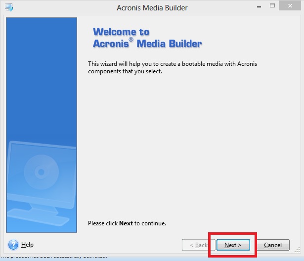

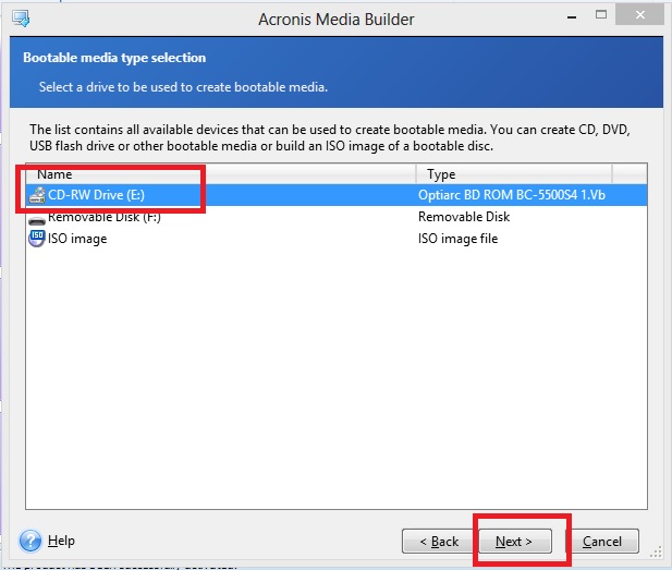

      To build the Rescue Boot Media is just as easy:
      32820-RescueMedia1
      32821-RescueMedia2
      I choose both of these.
      32822-RescueMedia3
      You can add command line parameters. I never do.
      32823-RescueMedia4
      Choose the location for your Rescue Media. It will fit on a CD. No need for a DVD.
      32824-RescueMedia5
      The screens are fairly self explanatory. Any questions can be added.

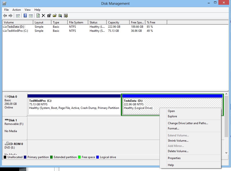

      Phil, you can add labels (names) to any internal drive in your PC quite easily.
      Click on My Computer, or open File Explorer. You should see all the drives in your PC. Right click the drives one at a time and select properties. In the Properties Dialog Box you can create labels (Names) to suit you. As you can see in my example I have 2 partition (drives) in my PC. I have labeled (named) then with very descriptive labels, in my case TedWin8Pro (C Drive) and TedData (D Drive).
      After putting in an appropriate label you will have to tell Windows to let you do this by clicking OK as the various warning windows pop up, but you will end up with a PC with drives able to be identified from anywhere.
      32884-AddingPartitionLabels

      Without reading the entire thread again, have you tried to use a partitioning app, even the built in Disk Manager to set the formatted drive to logical?
      For example if I were to format my D Drive, it it would leave a blank Logical drive since the C Drive is set to Active. There can only be one Active partition at a time, and that is the drive you are booted to.

      As far as I could understand from this thread, Phil has two disk partitions in a single disk. The D drive, which is a 2nd partition, is totally free so, although not the best practice (and that has been said to him several times in this thread), I see no reason for the issues regarding backup. I am neither familiar with EaseUS or the Windows backup functionality, but Acronis True Image is perfectly capable of backing up to another partition in the same physical disk. They even create a special zone when such partition is not available, although I never used that feature.
      Phil,
      I am quite certain the formatting did work. I cannot explain the repeated backup issues, though. The fact that the backup issues persist means the cause lies elsewhere and not on any issues with the D partition formatting.

      Ahhh, I think Clint has hit on it. I guess I should have reread the thread. Storing an Image to the same HD, even on a different partition, even using apps that technically allow it is somewhat dangerous as well. If the HD fails, you loose your Image as well. Also Clint does state that Win 7 Backup and Restore does not allow the same HD to be used. If you had 2 separate and distinct HDs then it would not be as dangerous to store your Images on the separate HD because there is much less chance of both HDs failing at the same time. But using a different partition on the same HD????
      On my system, if I Image just the C Drive, using the default compression settings, my Image is approx 20 GB in size. My Images include everything but the data.
    • #1369295
      One of these types of drives would be ideal for Phil’s laptop; Small, lightweight, and easy to carry with the laptop.
      You (Phil) should still be able to use the default Windows 7 backup and restore application if that is what you want, provided of
      course, you make a USB thumb bootdisk. If your laptop has a CD/DVD drive, better still.
      (Making a bootable thumb drives is very simple)
      All you will need to do is enter the BIOS and set the CD/DVD drive, or USB, as the 1st choice for booting.
      (Most newer laptops are setup that way to begin with)
      A bootdisk is always needed to restore an image from a non bootable computer, no exceptions.
      If you choose to use the Windows 7 backup and restore app you will need to create a Windows 7 bootdisk.
      If you choose to use EaseUS Todo image backup you will need to create their program’s bootdisk. To learn how go here.

      I do have 2 partitions on my laptop. The first contains the OS and all apps. The second contains all data. In this manner my data is separate from the OS. This allows me to Image just the OS drive and create smaller Images quicker than if I had just one partition. My data is backed up using File History and dragging files to 2 other PCs.
    • #1369396
      I have one physical disk, one partition, so just one logical drive. That works for me.
      Ted has one physical drive, two partitions, so two logical drives. It doesn’t cost anything to partition one drive into multiple partitions.
