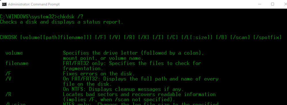

        You are incorrect; chkdsk is capable of much more.  Open a Command Prompt, type chkdsk /? and hit enter.  Here are switches pertinent to this discussion:
        chkdsk-switchs
        Chkdsk does indeed test for bad sectors and recover (where possible) data in bad sectors.
