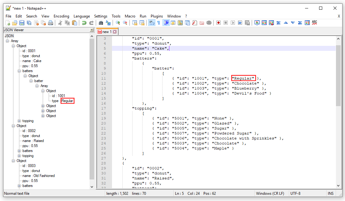

    • #2395678
      The PDF of JSON output viewed in Notepad looks entirely normal and fairly simply structured data.
      The problem is that JSON output can range from simple to highly complex and deeply nested.
      Perhaps try again but using the free Notepad++ and its JSON viewer plug-in?
      (The plug-in download contains both the NPPJSONViewer.dll plug-in DLL and a readme file. Open the readme file in Notepad++ for instructions about how to copy and install the plug-in.)
      For example, the complex nested JSON data in the right-hand pane is shown in the JSON viewer in the left-hand pane.
      json_viewer
      (I’ve highlighted a single data fragment so you can see the correlation between the raw nested data and how the same data appears in the viewer when you drill down to it.)
      mpw
