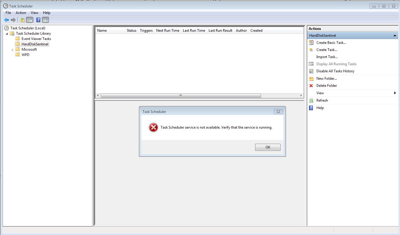

              I don’t have the Trial Version either. We both have the same version. I heard from the developer and he says that the program actually starts from the Windows Task Scheduler. When I check the Task Scheduler it shows the HardDiskSentinel folder is there but no tasks are visible. When I click on Display All Running Tasks, the message shown below pops up. I checked Services and the Task Scheduler Service is running and cannot be stopped. Looks like I have a problem with the Task Scheduler. It doesn’t recognize that the Task Scheduler Service is running. Have you seen this problem before? I searched Google bit no fix there.
              Thanks, John

              Hi John,
              No i have not heard of this kind of problem before.. Am i understanding that you can’t change the settings in “Services” ? See Screen Shot’s of my OS… Just in the case there is some corruption you could try running … sfc /scannow (system file checker) from an “Elevated Command Prompt”.. If some file has gone corrupt this will try to repair it.:cheers: Regards Fred
              PS: You might try to “Create the task” yourself …just click on it and follow the screens

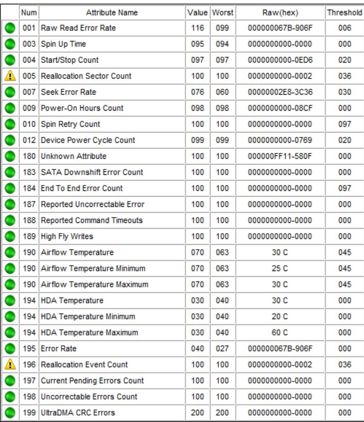

              Okay, thanks Fred. Health meter at 40% identified as “Acceptable”. The ? beside Health did provide lots of information, most of it a tad over my head! Screen did include this note in a yellow box below the meters:
              Problems occurred during the spin up of the disk 526 times. This can be caused by the disk itself or huge power load (weak power supply).
              At this point, warranty replacement of the disk is not yet possible, only if the health drops further. It is recommended to examine the log of the disk regularly. All new problems found will be logged there.
              It is recommended to backup often to prevent data loss.
              The Performance meter said Excellent.
              My understanding from all this is that the disk is healthy for the moment, but has fewer hours remaining on it than it once had. We should likely not rely solely on it for critical updates (i.e., images) but should have another backup in place as well.
              Do you think I’ve interpreted things correctly?

              Hi Linda,
              Yes… you have … The HdSentinel program identifies problems ( some possible future) The full program ( pay for Pro) will keep you apprised of any further developments, with real time warnings.. One question have you figured out why the external seems to at times disappear ..and the reappear on it’s own?

          Re. the good old hard drive issue, I took a screenshot of what Roderunner’s HDDScan program found when I ran a S.M.A.R.T. scan on it today – when it was actually showing up. Wondered if those 2 yellow items suggested what might be causing my issues with this drive (having trouble letting this go, I know!!). Attached it in case it suggests anything.
          Thanks for any input, as always.
          Linda

        I figured you wouldn’t get much out of this particular screen shot, but Sentinel is equally confusing since it tells me all is well aside from being only 40% “healthy”.
        Do you think my strategy (i.e., be safe, buy new drive, do backups; reformat current drive) is a sound one, given all we’ve done in this thread?
        Linda,
        HdSentinel Pro “Trial” Is not a fully functional program …it just allows you to tell if it can work with your hardware… Your backup paradigm is fine as long as you realize that the “Plain Jane” Hard Drive is not really meant to be continually be swapped around (has exposed components that you should be aware of ) So as long as you treat it “gently”( don’t walk across a carpet and touch the exposed components) it will be fine…I store mine in “Bubble Wrap Static proof bag ” and in a small cardboard box after any operation “Cloning”, “Imaging”, or updating my data. :cheers: Regards Fred
        PS: I would “Play ” with the old drive …but wouldn’t trust it.

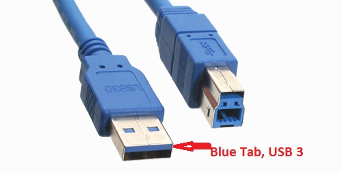

      This is an Ext HD. It comes complete in a sealed enclosure. It connects via an included USB cable to a USB port on your PC. I actually have a smaller version (portable version) similar to this. Mine is smaller and easier to carry with me should I choose to do so. The Desktop version is a little larger and slightly less mobile as a result. Both come with the same S/W installed.
      USB 2 is the older version of USB. I do not remember if you said, but a USB 3 port will work with a USB 2 device. I am not sure if the reverse is true, probably not. Most PC’s, if they have USB 3 ports also have USB 2 ports, although a USB 3 port should work fine with your USB 2 device.
      You can generally see the difference between USB 2 and USB 3. The USB 2 ports and devices have black or white colored plastic tabs, the USB 3 generally have blue tabs.
      31269-b51110_214e_13519-img6023s31270-images

        Wow, Ted, fabulous information + images. Thank you.
        I must have been buzzed last night when I posted. Just reread what I’d said re. USB’s and I meant “store rep said I could go with a USB 3.0 as it’s backward compatible”, not USB 2.0. Sorry! From what you said, sounds like he was right (i.e., if I bought a 3.0 it would work in a 2.0 port), although your images suggest that they look quite different at one end anyway.
        Think I’ll just stick with this 2.0. It is so well priced that I can upgrade to a 3.0 when we upgrade our computers (not for a while – both are under 2 years old).

      This color coding is generally on both the PC USB plug and the device and cables. My granddaughters new PC had 1 each USB 2 port (had black plastic tabs) and 2 each USB 3 ports (blue plastic tab) This seems to be a standard although I have heard not all manufacturers use this color coding as standard.
    • #1337675

    • #1348414
      Thanks for the article and the advice re. HD Sentinel. I’ve attached a screenshot of the SMART results just now.
      Linda

      HERE is a source (wikipedia) of information on SMART attributes to read through.
      Much of the SMART attributes you’ll find will depend upon the hard drive manufacturer, they may have their own specific
      attributes set into SMART and info on how to interpret them. (Many are vendor specific)
      Your’s don’t look too bad though, at least not bad enough to effect an RMA right now, but I would definately keep an eye on
      things and not soly rely on one drive, as I have also learned recently too.
      I would also do a vendor specific search for their attributes and attempt to correlate them with what you have.
      You might also correlate those values with what another utility shows as well, like CrystalDisk info. You’ll probably see some variation.
      It’s also a good idea to find out what the hard drive vendor recommends, if any, in terms of a SMART monitoring tool too.
      I’ve been seeing something similar to what your seeing with your drive with my Vertex EX3 SSD in terms of health and performance
      degridation, but not nearly as pronounced. At this point an RMA is not possible. But the drive should be monitored regularly/closely.

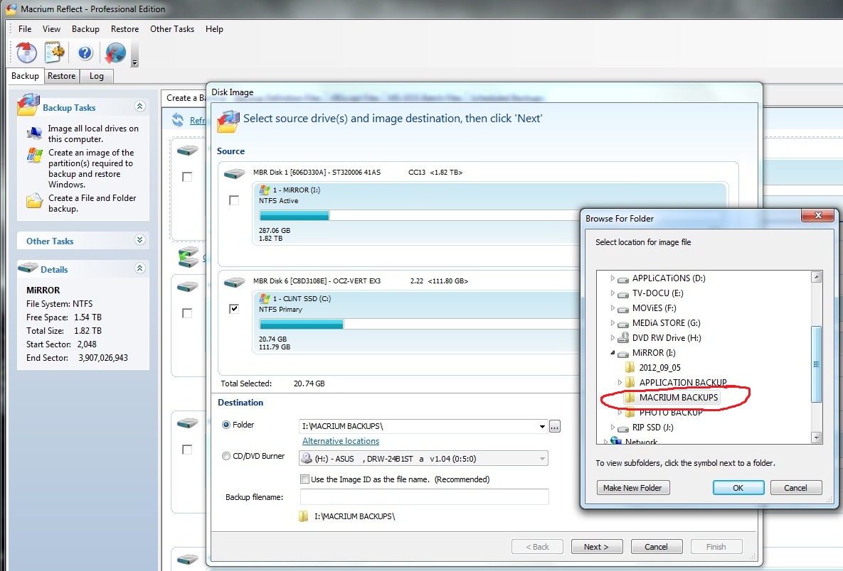

      31949-Untitled2
      Select the primary drive your Windows OS is on.
      Then select the drive you wish to store the image on…
      31950-Untitled3
      Don’t make it anymore complicated than it need be. Get comfortable using the program to create a simple image
      that can be easily restored via the boot disk you just made. That should be your only goal right now;
      Making an image and then successfully restoring it with the bootdisk.

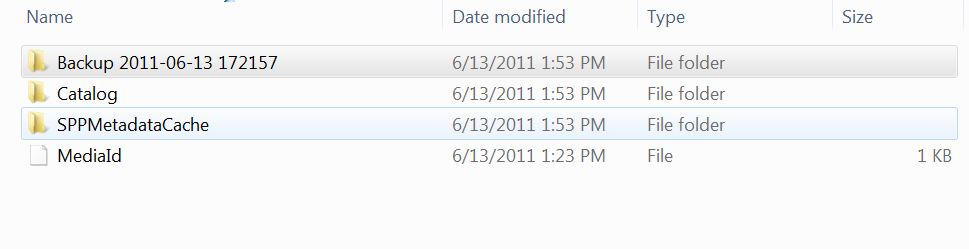

      If you want to get the backup images off of the old external drive use windows explorer to copy them off.
      They will look something like this…
      31951-Untitled1

            It’s been a while, but … Went to backup PC just now and Macrium offered a download to a new version.
            2 Questions (topic 1):
            1. Do I download it?
            2. If I do, is this the time I make a new boot CD as J P Fred suggested in #129?
            1 Question Topic 2: hard disk health
            In Hard Disk Sentinel (still free version) my C drive has now been registering 48% “health” with 38 bad sectors and “excellent” performance since December 12, 2012. Does this suggest it may NOT be failing after all, just picking up some bad sectors? I still plan to install the new drive (which I have bought) – I’m just curious.
            Thanks,
            Linda
    • #1359795
      No
      Once you’ve established that you can effectively restore an image via your created bootable disk, one time is good. (desktop)
      If your Macrium boot disk works on your laptop, then no need to make another.
      Verify the image by doing a restore, if you have not already done so on the laptop. Remember to include any hidden partitions.
      • #1359828
        Thanks for your super fast reply, Clint – and for more helpful information. Will be sure to do the scary restore after I create the laptop image!
        One clarification:
        Is there something I need to do to ensure I have included them? Sorry, but I know little about partitions, except that you can partition disks. I never have, however!
        Again, many thanks!
        Linda:)
    • #1368328
      Yes, by all means, you may download the latest version. I know Macrium installs over my current version without issue.
      I have been able to use the same boot disk that I had previously made, but you may want to test it to ensure
      it’s continuing viability with the new version, as I have.
      When in doubt about any particular hardware monitoring app, get a second, or even a third opinion, by downloading
      one of the many hard drive S.M.A.R.T monitoring tools we’ve previously mentioned.
      If all these tools (generally) concur with each other, then you may start planning for a new drive.
      • #1368460
        Okay and thanks. I will do some further checking on the current disk and will download Reflect update now.
        you may want to test it to ensure it’s continuing viability with the new version, as I have.
        To test, do I just boot from the original CD and see what happens?
        Linda
    • #1368572
      Yes, boot from the disk you have made and locate your backups on the external drive.
      If everything checks out you should be good to go.
