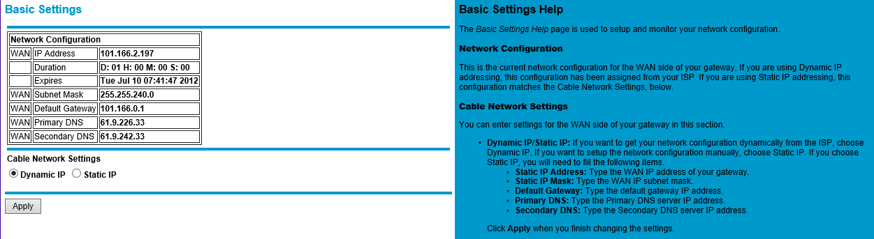

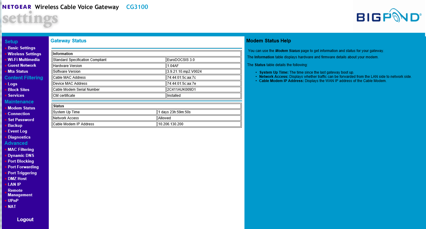

AskWoody LoungerJuly 9, 2012 at 2:46 am #1339858Can you post a full page image of what you see when you access your router. 30306-Make-an-Image-and-post-it
WSlmodra
AskWoody LoungerJuly 9, 2012 at 3:21 am #1339861Hi Roderunner,
Capture1 is what appears when I log onto the router, Capture2 is just the Basic settings page without the LH menus31397-Capture231398-Capture-1

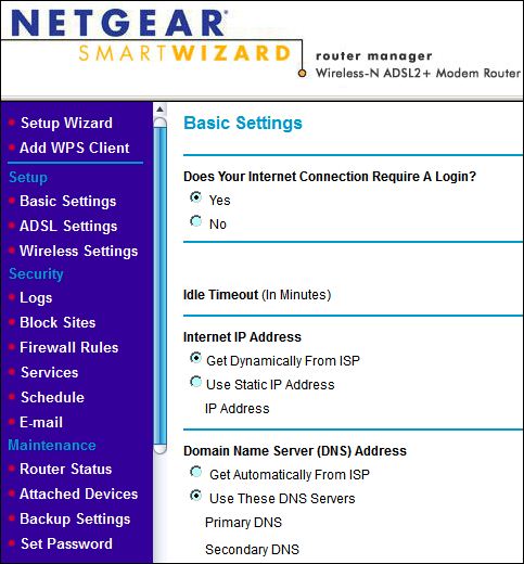

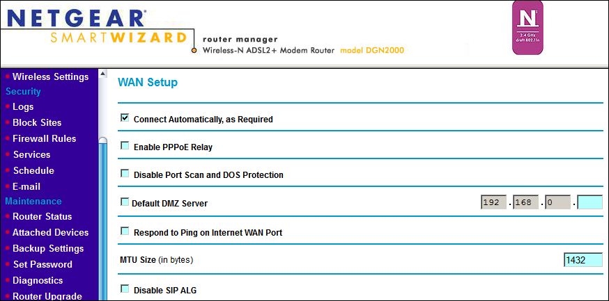

WSRoderunner
AskWoody LoungerJuly 9, 2012 at 3:59 am #1339864Hi Imodra,
In your image, Capture 2, change the Primary DNS to 208.67.222.222 & Secondary DNS to 208.67.220.220
These are the settings for OpenDNS and can be used without opening an account. In case you have to return to original settings keep note of them.
Contact your ISP for information on the correct MTU to use and how to change it in your router. The default on most computers is 1500. -
WSlmodra
AskWoody LoungerJuly 9, 2012 at 4:32 am #1339868Thanks for your prompt reply. However the DNS settings are not accessible when Dynamic IP is selected. They do became accessible when Static IP is selected, but the ISP specifies use of a dynamic IP. I have an account with OpenDNS, and used their DNS servers with the previous router supplied by the ISP. So had tried to set them up prior to this intermittent disconnection occurring.
