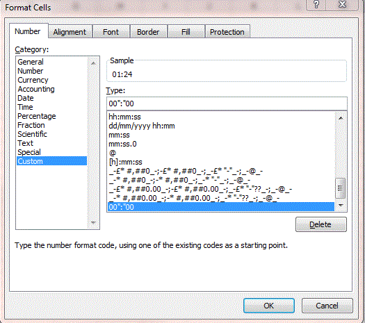

    • #1587136
      Hi MNN
      If you really want to do this without a macro, then try this:
      Let’s assume your Time entry is in column [A]
      Then, click the column [A] heading to select the entire column, and apply this custom format:
      00″:”00
      46268-rz-format-hhmm
      Now, with the same column selected, use Data>Validation to restrict entries to numeric whole numbers between 1 and 2400
      46269-rz-data-validation1
      Now, if you want to use these time entries in any calculations, you could use a ‘hidden’ column with this formula in cell [B2]:
      =TIME(TRUNC(A2/100),MOD(A2,100),0)
      ..and copied down as required
      ..see attached example file
      zeddy
