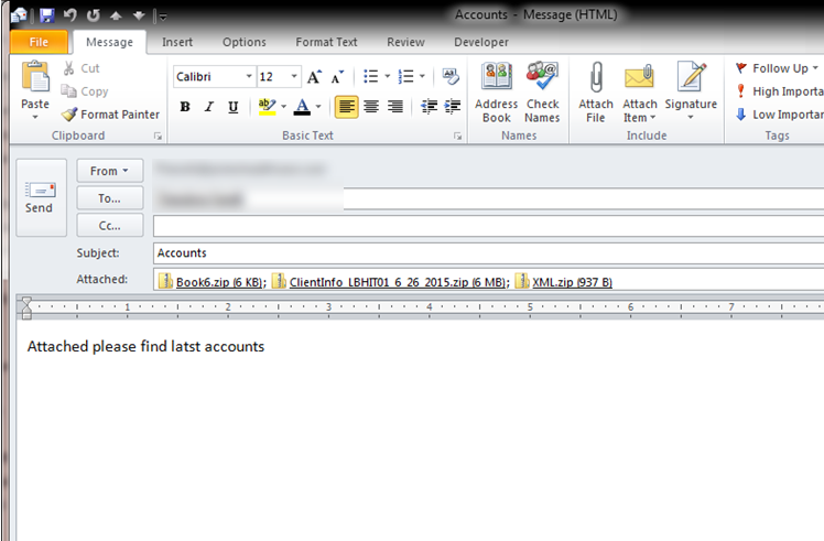

      • #1532249
        Hi Maud
        You provided me with code to attach zip files in a folder. Is it possible to attach 10 files per email as the file size is too large as some companies limit the total file size to 10gb. If so kindly amend the code so that the first 10 zip files are attach to email 1 , the second 10 to email 2 etc until all the zip files have been attached
        It would be appreciated if you would kindly assist

    • #1521870
      Hi Maud
      Thanks for the positive feedback and for your input
      I have modified the code to
      Code:
       If InStr(1, oFile, "Backup", 1) > 0 Then
              Else
                             If CStr(oFile) Like "*.zip" Then
                      .Attachments.Add CStr(oFile)
                  End If
