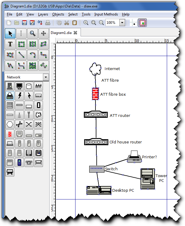

          You’ve told us the basic details of the hardware (but specific make/model would help, e.g. of old house router).
          Now perhaps tell us… what sort of setup you want to end up with?
          For example, just one big physical LAN or 2 physical LANs for security/separation purposes, e.g. keep cameras on seperate LAN to other network traffic which may include guests using wifi for phones/tablets, etc.
          I use the freeware Dia Portable from portableapps.com to create really basic network diagrams. For example:
          one_big_network
          It doesn’t have to look pretty ‘cos it’s only there to show connections.

    • #2223675
      You don’t need a smart switch, just a cheap (dumb) Gigabit ethernet switch is all you need – around $20.
      Is there a reason you are using 2 routers? Att router to switch would be enough.

    • #2252166
      I think you are making this more complicated than you want it to be. Unless you are well versed in double routing and the problems you will need to solve, I highly recommend you simplify your plans. Otherwise you may find yourself in a difficult to manage and troubleshoot mess.
      Use only ONE router – located in the wiring order at the entry point of your Internet connection. If you need more physical ports than the router provides then place a switch directly after the router. If you must, you can also wire a long run from the switch to another part of your home and place a second switch there (but not another router!)
      Your Wi-Fi — if not provided already by your router, can be connected to the switch(es). Same for cams etc. In this plan, the Wi-Fi unit cannot be a second router.
      In order:
      Internet modem >> router >> Switch >> Dedicated Wi-Fi AP + all devices.
      OR
      Internet modem >> router with integrated Wi-Fi >> Switch >> all devices.
      OR
      In the case where your internet modem is also a router and Wi-Fi then:
      All-in-one Internet “box” >> Switch >> devices.
      Hope that helps!
