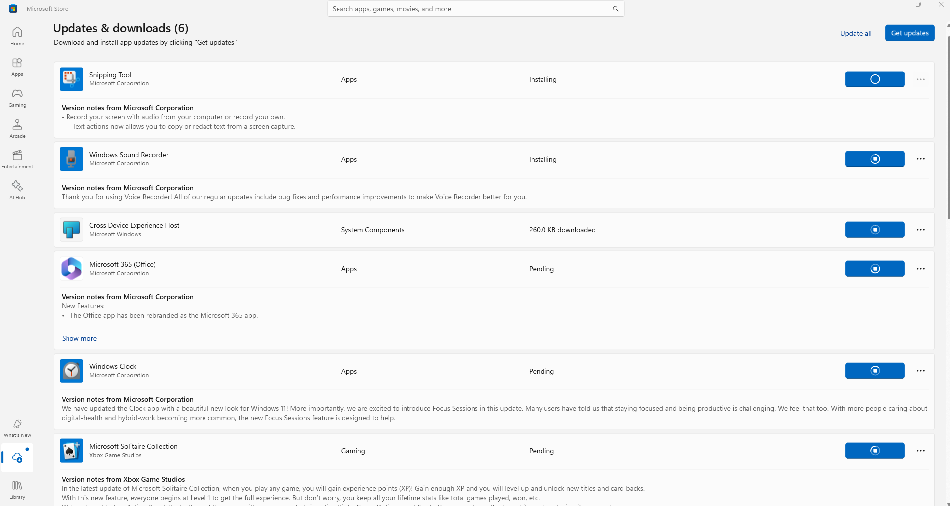

    • #2699855
      This seems to have gone through fine, and then I ran the Microsoft Store updates, and that caused an issue — never had any issues with it before.  While some updates went though as they have always done before, these seem to be not doing anything.

    • #2699872
      Screenshot-AskW
      I just tried re-registering Microsoft Store  — https://www.elevenforum.com/t/re-register-microsoft-store-app-in-windows-11.2408/#Two  — and it doesn’t seem to be helping
      EDIT: Actually, just restarted the computer, and now it seems to be working!
