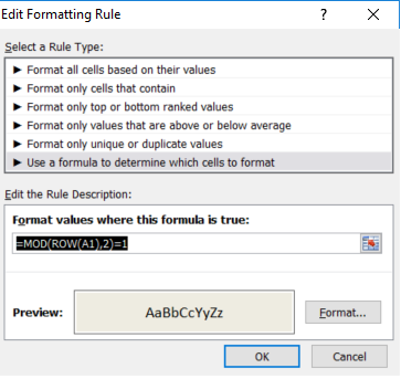

      The Ledger Sheet has alternate rows of shading using conditional formatting. Shading maintained when inserting or deleting rows.

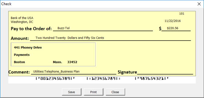

      Double clicking a record opens a form view of the check. Editing can be done on the form view or directly in the ledger. Checks will include the address to show through envelope window. No need to store images of checks as they will display on the fly. A print button on the form provides a screenshot hardcopy if desired
      46084-Checks5
