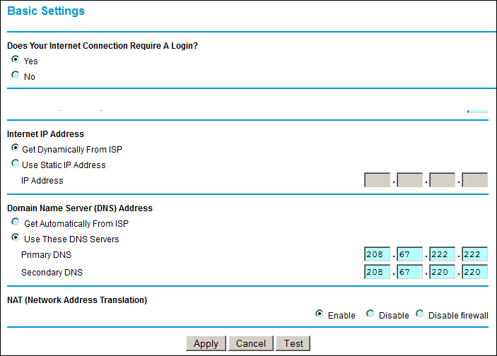

I have just looked at my router settings. It’s a Netgear. Do I go into Basic settings and unclick “get DNS dynamically from ISP” as it is now, then input the new configuration? There are boxes for Primary and Secondary and the namebench software did give me a Secondary ( the one I have currently) and also a Tertiary 2001:47:20::2 Hurricane Electric IPv6. Do I need to input both the new one and my current one and where do I input the Tertiary? Sorry to be so ignorant!
WSRoderunner
AskWoody LoungerApril 5, 2012 at 6:38 pm #1327861These are my Netgear settings using OpenDNS. Read the info on the r/hand side of your page before starting.
WSRoderunner
AskWoody LoungerApril 5, 2012 at 6:42 pm #1327862These are my Netgear settings using OpenDNS. Read the info on the r/hand side of your page before starting. You don’t have to alter your pc settings.

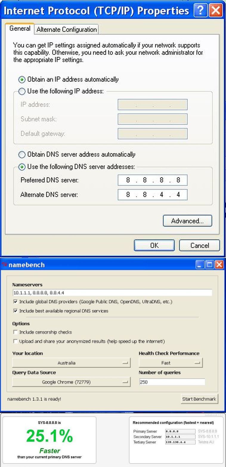

AskWoody LoungerApril 12, 2012 at 12:15 pm #1328700I hope it’s ok for me to piggy-back this thread.
Because at the moment I don’t understand some conclusion that the recommended app (namebench) comes to in my case.I use Win-XP-Sp3.
Modem = Siemens Speedstream 4200 (supplied free by my ISP)
ISP = Optus (I think 10.1.1.1 = OptusNet DNS server, but I could be wrong).
Connection = ADSL2+In the image following:
– top pic = how I’ve defined DNS servers in my TCP/IP properties
– middle = what namebench displays when it starts up (seems to take 10.1.1.1 as address of primary DNS server)
– bottom = what namebench recommends after running.My settings in pic #1 are intended to override my ISP DNS.
Does this NOT happen?
Because namebench seems to regard 10.1.1.1 as the current primary DNS server and recommends that I should change to the Google DNS server (pic #3), which I though I’d already done (pic #1).Can someone decode this “anomaly” for me?
Am I supposed to tweak the modem’s settings to turn off the ISP as primary DNS source in addition to the override as in pic #1 (the modem was installed with its software wizard without any tinkering from me); I know nothing about it and don’t want to lose my internet connection by making mistakes.Help/patience appreciated.
