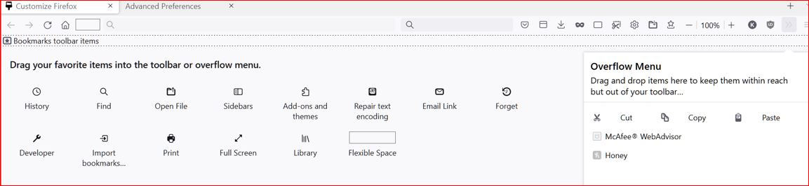

    In addition, I do not see any change in the Customize Toolbar option. It looks like this:
    no-change-in-Customized-Toolbar

      • #2383412
        Here they are side by side. I do NOT see any difference in the spacing between toolbars nor in the spacing in the tabs, whether the preference is ‘true’ or ‘false’
        In reply to Ascaris (#2383380-below), I had not been using the Proton “compact (not supported)” pref before, but it’s clear that although the “browser.compactmode.show” preference is present, toggling it doesn’t do anything.
        compact-mode-side-by-side

    • #2383432
      Perhaps the horizontal ‘spacing’ is not meant to be changed, only the vertical ‘spacing’.
      Are you also wanting the ‘compact’ view as shown in the ‘[Tip] Restore “Compact Mode” Density Option in Firefox Customize Window’ page – https://www.askvg.com/tip-restore-compact-mode-density-option-in-firefox-customize-window/ ?
      It appears like that because the FF Browser Window has been made horizontally smaller for clarity and to fit within the webpage spacing. The changed ‘compacted view’ is a consequence of changing that Window size.
      • #2383434
        Your live screenshots have explained it completely!! And my window had not been expanded enough vertically to show the buttons/boxes at the bottom. Thanks for your help!
