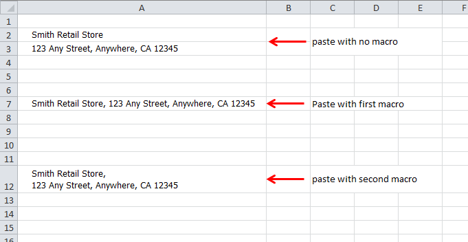

        The problem you are experiencing in the embedded carriage return between the 2 lines of the address. When pastedThe following macros will take both lines and put them into one cell simply by just right clicking the cell.
        The first macro will enter the lines on one line in the cell. The second macro will insert an Alt-enter and stack the 2 lines in the cell. Place the macro in the sheet’s module and delete it when you are finished.
        35831-RightClick
        Macro 1: one line
        Code:
        Private Sub Worksheet_BeforeRightClick(ByVal Target As Range, Cancel As Boolean)
        Cancel = True
           ActiveSheet.Paste
           text1 = Target.Value
           Target.Value = text1 & “, ” & Target.Offset(1, 0).Value
           Target.Offset(1, 0).Value = “”
           Target.Select
        End Sub
        Macro 2: multiple lines
        Code:
        Cancel = True
           ActiveSheet.Paste
           Target.Value = text1 & Chr(10) & Target.Offset(1, 0).Value
           Target.Select
        End Sub
        Note: This works for copy/pasting one address at a time. I will work on a multiple copy/paste.
        HTH,
        Maud
