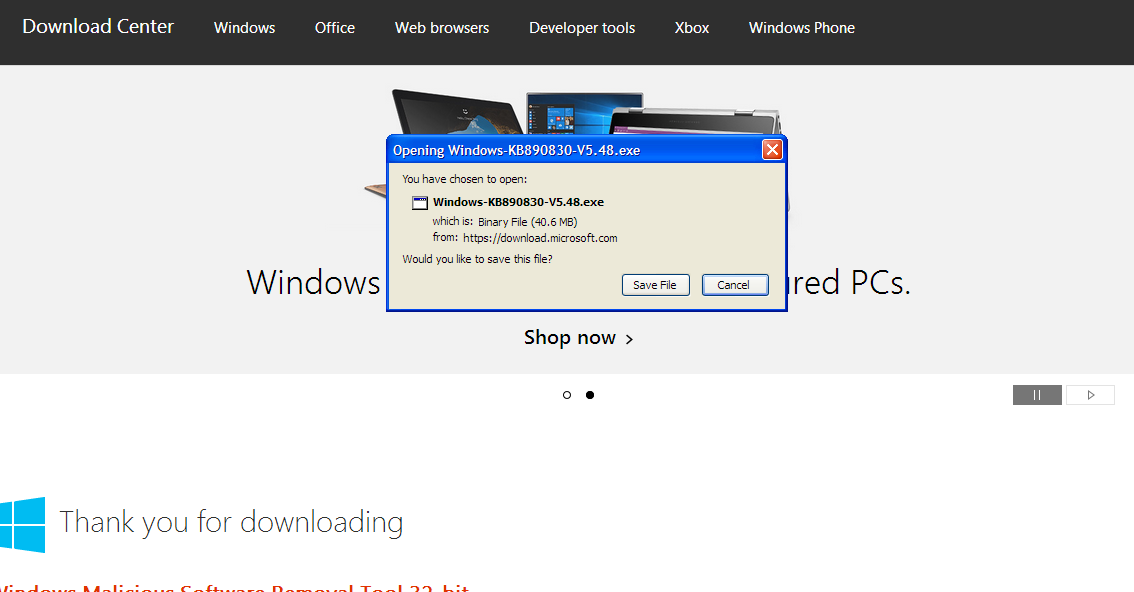

            • #118393
              PKCano – still no luck.  Could you upload a copy of your file here?  If not possible, maybe to me?  Thanks.
      • #118395
        The file is too big to upload. But here is the link to the download Center
        Screen-Shot-2017-05-27-at-7.49.33-PM
        Mark 32-bit then Next
        Screen-Shot-2017-05-27-at-7.50.31-PM
        Then Normal download
        Screen-Shot-2017-05-27-at-7.52.12-PM
