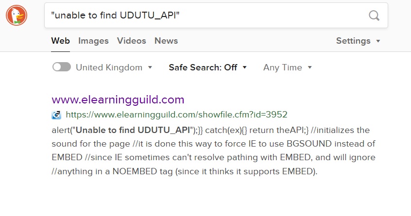

      • #1851708
        According to the contents of the search result in my image above, it’s designed to work via IE.
