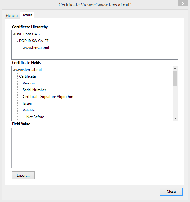

      • #1583447
        What *I* use when I’m traveling is a free utility from the U.S. Air Force Research Lab called “TENS” (Trusted End-Node Security). You can download a public version ISO from http://www.tens.af.mil.
        That TENS sounds interesting, but when I clicked on the link I got: “Your connection is not secure…”
        45951-TENS
        • #1583451
          45951-TENS
          Did you try with a different browser? Looks like FireFox didn’t like it.
    • #1583541
      The connection is invalid because the DoD use self signed certificates – why would they pay a commercial organisation to authenticate them when the government has already done that by creating them.
      You can add the root certificate to your trusted store and all will be well – assuming you trust the DoD / US government. 🙂
      45954-Capture
    • #1583551
      Thanks guys. IE opened the page after a stern warning.
