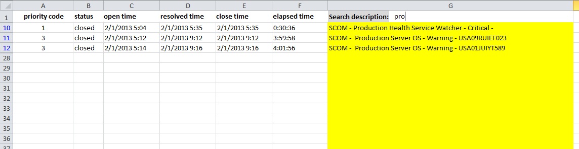

    • #1376484
      As an alternative, by placing a textbox on the sheet, you can type in any word/phrase then doubleclick. The rows will be filtered by the occurence of the entry in column G. To return to all the rows being visible, simply deselect the filter icon in the Menu.
      33236-Filter
      Code:
      Private Sub TextBox1_DblClick(ByVal Cancel As MSForms.ReturnBoolean)
          ActiveSheet.UsedRange.AutoFilter Field:=7, Criteria1:=”*” & TextBox1.Value & “*”
      End Sub
    • #1376582
      Maud
      That’s a nice solution.
      However, I prefer to avoid the addition of a Text box.
      It can be done with entry to a given cell (I used G1) and the Worksheet change event.
      I think this “looks a little neater”, and just deleting the entry in G1 returns to the full list, as opposed to having to clear the filter.
      Code:
      Private Sub Worksheet_Change(ByVal Target As Range)
          Dim c As Range
          If [G1].Value = "" Then
              ActiveSheet.UsedRange.Offset(1).AutoFilter Field:=7
          Else
              ActiveSheet.UsedRange.Offset(1).AutoFilter Field:=7, Criteria1:="*" & [G1].Value & "*"
          End If
          For Each c In Range(Cells(2, 1), Cells(2, 6))
              c.AutoFilter Field:=c.Column, Visibledropdown:=False
          Next
          [G1].Activate
      End Sub

    • #1376948
      Dynamically filter rows by description column (G) as you type in search. No need to click elsewhere to activate filter or to remove filter. Deleting the search criteria returns full list. Even cleaner with no filter icons showing. One line of code.
      33258-filter2

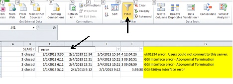

      • #1410245
        Hi Maudibe
        Very nice method of dynamically using the textbox for the search text!
        I like that very much!
        Instead of using textboxes to overlay and ‘hide’ autofilter dropdown arrows (nice trick), you can just use the
        visibledropdown:=False
        ..property to turn them off.
        (You can choose the columns you want for displaying/hiding the autofilter dropdown arrows.)
        Roger’s code included hiding the autofilter buttons.
        see attached file for my version.
        zeddy
